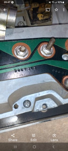

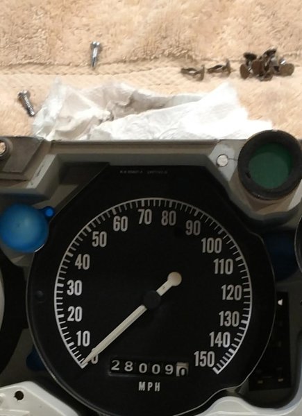

This might help, hopefully. The spring clip fasteners attach the lens assembly to the gauge housing.The short chrome-type screws attach the gauge assembly to the faceplate. The long black screws attach the entire item to the dashboard.
This might help...from left to right, at the bottom: push pin fasteners attach the lens assembly. Next, short screw attaches faceplate to the housing. On the right is the hole that receives the long black screw to attach to the dashboard, itself.

The glass is held to the cluster frame by metal push pins. Best to lay the face plate on the cluster housing and make note of the bezels holes. The cluster might have separate screws that hold it to the dash frame. Brain is a little rusty this morning.
Lens installed w push pins.
