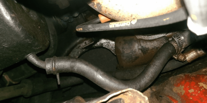

Looking to dress up the engine bay to how it looked from the factory.
1. Were the PS pump caps painted black or did they leave the factory silver?
2. Were the carb springs all green with the orange strip for a 383?
3. Did the power steering return hose connecting to the PS pump & gear box come with the red clamps? Mine had a corbin clamp and a worm one on it when I got the car. I'm pretty sure it was the orig. hose

Corbin clamps on 68 PS return line

Red spring clamps on ps return

Thanks Guys. I have a Federal PS pump. Anyone have any survivor pic's of the PS return hose clamps.
Got some info from Rick Ehrenberg. Federal caps were zinc plated. TRW units got a black cap. Return hose gets the red spring clamps.
