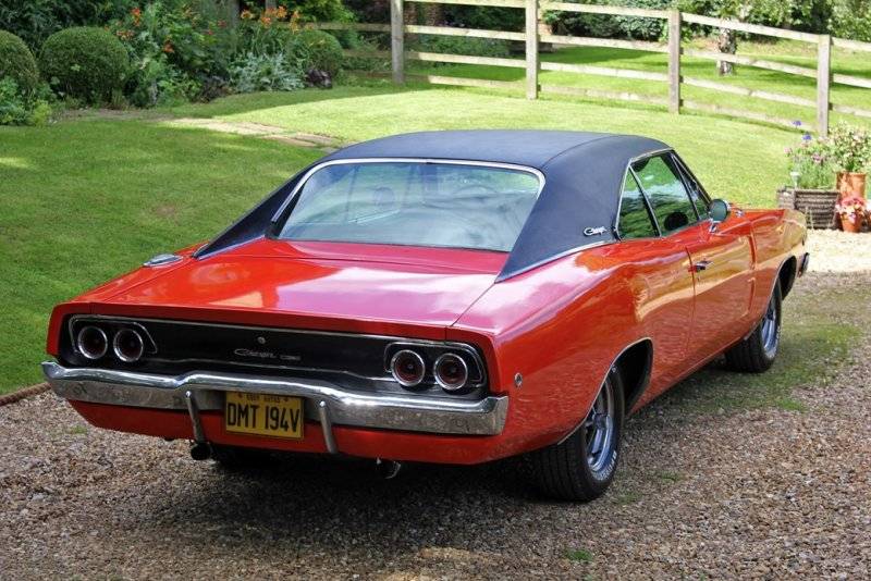

These are what you are searching for.

Yes, Google 68 dodge charger images. And look for yourself.
