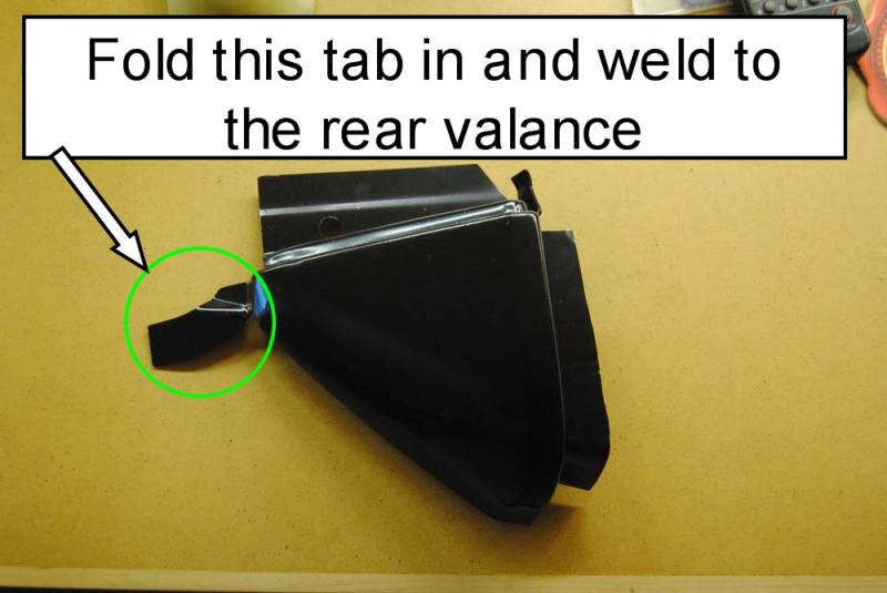

I’ve started putting my new rear valance on my 68 charger and I’m looking for some photo help as to how the bottom of the valance is connected to the cross member. My car was bondo city in this area so I don’t have anything to go off of. A couple of shots looking up from under the valance should do the trick if someone can help?
I also don’t know what to do with the tabs on the valance end caps from AMD. Do they get bent over somehow or cut off?

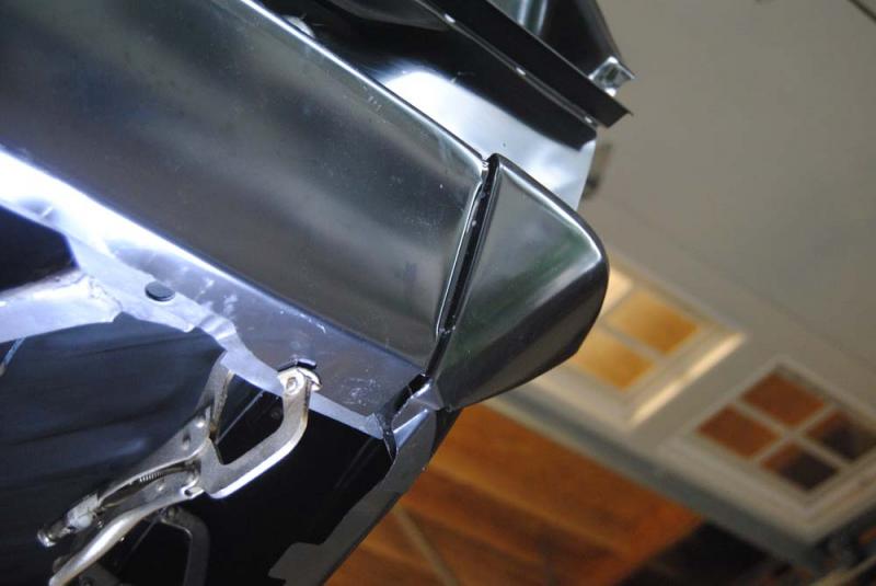

Thru conversations with the guys at AMD I received the following pics to answer these questions.

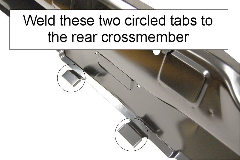

Correction. The tabs get bent forward and welded to the quarter panel. I talked to the guy at AMD and he said he the info before was a mistake and it had been a while since they did a charger. He also said originally the rear valance doesn’t get welded to the corner or the cross member at the ends – just floats and fill the joint up with seam seal. AMD admits their rear valance is a flatter arch than the original. I believe I will create a tab to go from the corner to the rear valance at the bottom to hold the rear valance in place
