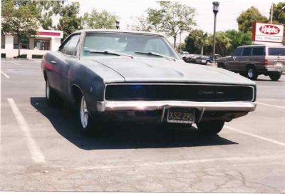

This is mine with a 15x8" wheel with a 295/50/15 tire. I forgot what the backspacing it but it fills the wheel well pretty good.

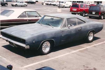

Here is one with a 15x10 wheel and 325/50/15 tire
Thanks for the post, the 15x8 looks like its a pretty nice/full fit. A little difficult to see with the pictures, but that shot with the 15x10 325 sure does look pretty bad ***... Not sure it would be entirely legal in Oz, so will need to check that out. Are you 100% sure that would fit without any modifications, its looks massive!!??
