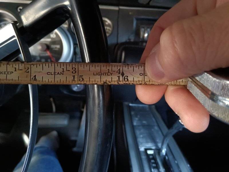

Looks to be 15.75, holding the tape and taking a photo at the same time.
