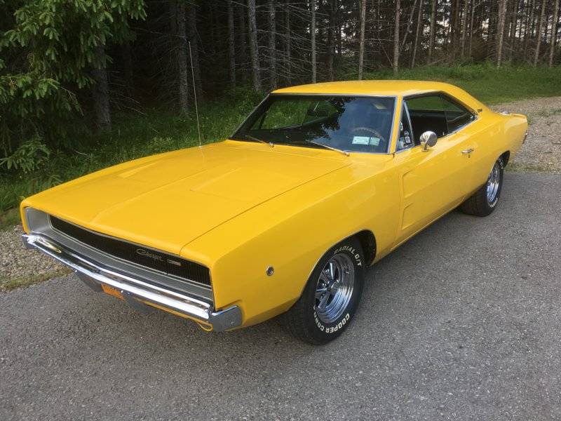

Well windshield is in. With the new gasket I’m surprised how easy it went in. So glad I did it myself and didn't pay someone. Turned out awesome and then with the new stainless trim and new windshield clips everything fits like a glove. Thanks to 69bfan for the parts and help! Awesome guy to deal with!! Here she is all installed and ready for cruise night!
I don't understand, did you install it yourself ?
Sorry man I forgot a "didn't" word in there! Man I was so excited to get this thing out and see how it looked that I didn't type it right. :)
