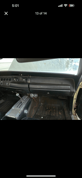

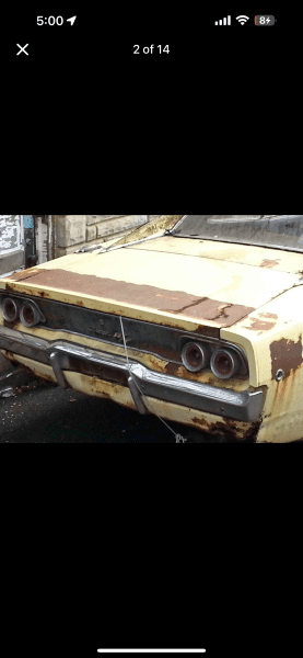

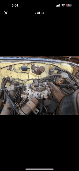

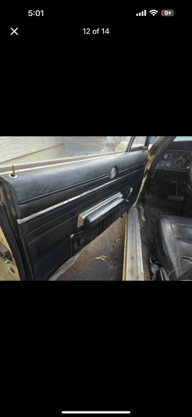

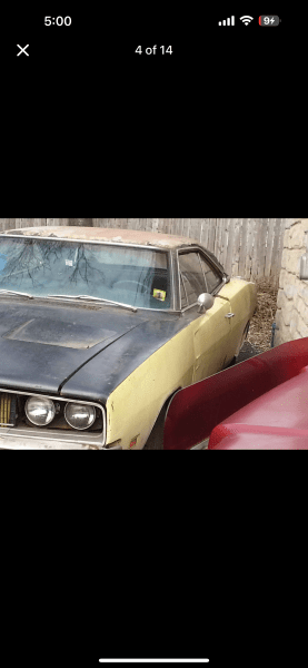

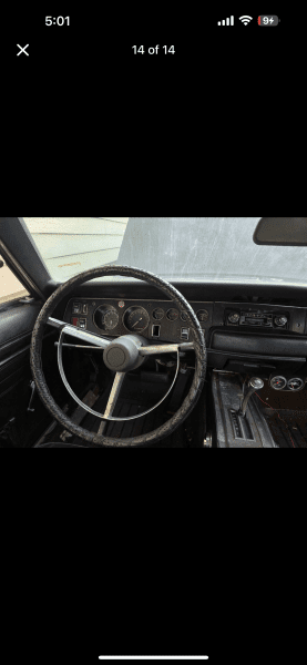

Thank you guys for your help, these are the pictures I have for right now, I will keep you updated.
68 Charger 69 grill, or front clip. Looks to be mostly there. If any of the numbers match, engine transmission, probably a 20K or more price tag in today's money. I have seen real junk sell for more.
If its a real RT hes asking more then $20 close to $30 Im thinking. Make sure you crawl under it and check the frame rails. Post pic of fender tag if possible Dont rush. JMO Auto RT most likely 8 3/4
