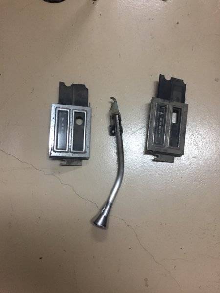

Should work, so long as what I have are the same prnd21’s as you have. Shifter slips right through the round opening. Will also fit the rectangular one with excess play
Should work, so long as what I have are the same prnd21’s as you have. Shifter slips right through the round opening. Will also fit the rectangular one with excess playView attachment 561078

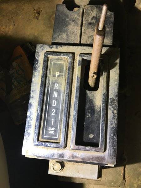

They sure look the same! Only difference I can tell is mine says “slap stick” below the “1”. that’s super exciting! Thank you! I have a friend Willing to part with one but I didn’t want to disappoint myself when it didn’t work haha
I started second guessing and had to brave the 4 degrees to double check that it really did say slap stik haha
