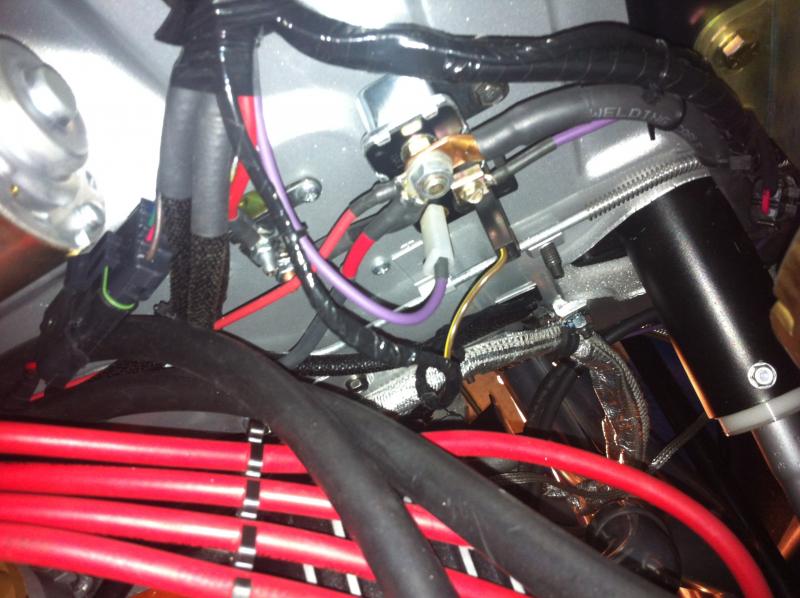

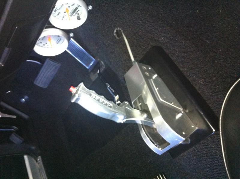

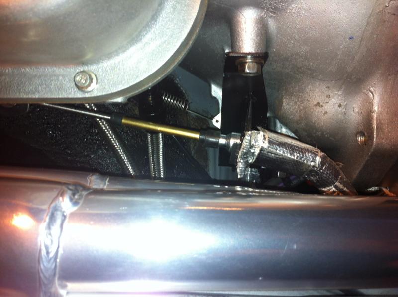

Heres what I came up with looks like I amy have solved the problem.
