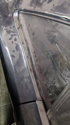

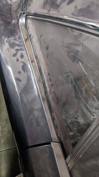

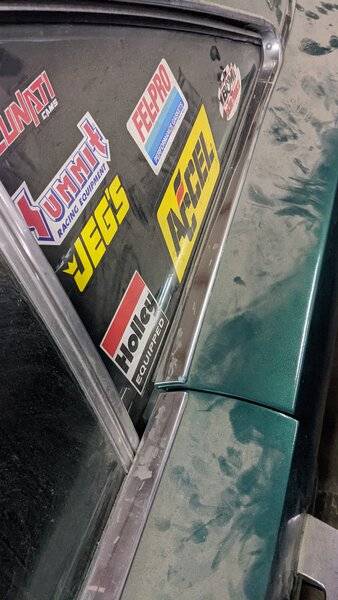

Coronet and charger (in green). The charger pieces are wider. I can't find a photo of a Coronet with the door and quarter pieces and I can only find the quarter pieces in my stuff
