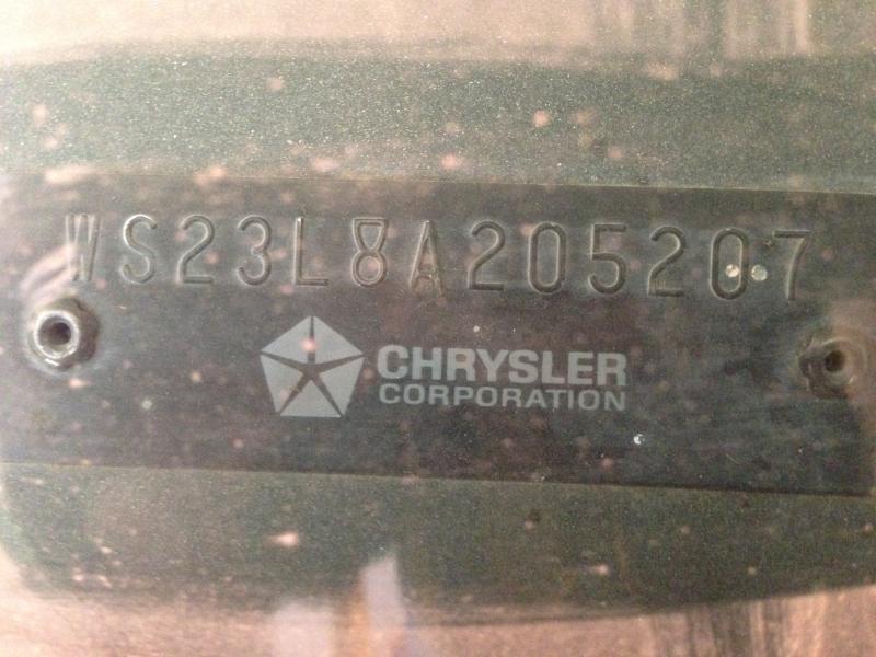

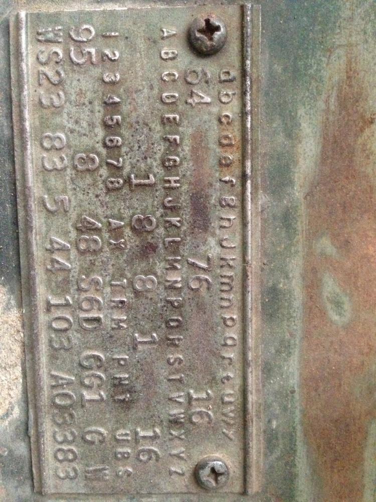

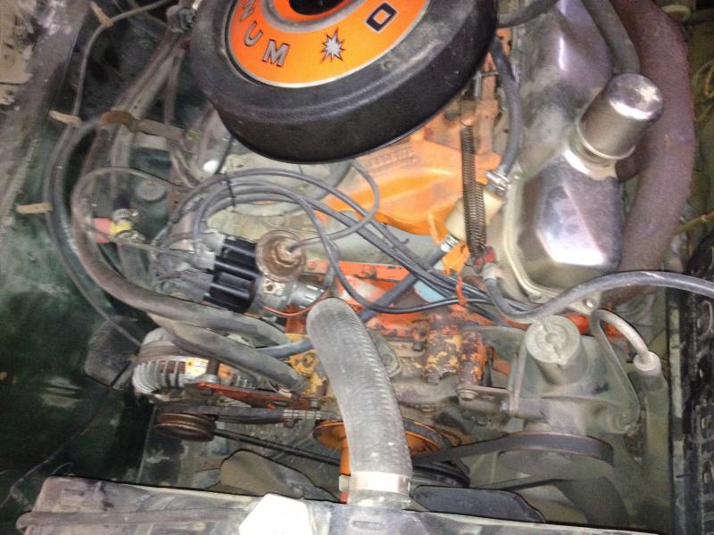

I'm not sure if i'll get to building my project right away or not as i'm waiting to hear from a fellow mopar brother on acquiring his project so i'll be on the road this summer but I thought i'd post a few pics of my project and get some help from you all. I've got the vin number and fender tag decoded i think. Picture of vin and fender tag included.Tell me if i got it rite:
Car: Dodge Coronet R/T 2 door Hardtop
Engine: 440 cid 4bbl Hp V8
Transmission: 3 spd auto
Tires F70x 14 Redside wall, steel belted
Build Date: Jan 03
Axle: 3.23 Sure grip
Int: Sport Trim, Vinyl, White on Green
Paint: Monotone Racing Green Metallic Paint
Other: Dark Green Metallic Uper Door Frame Color, White Horizontal Accent Stripe
H1: Power Brakes, K8: Power Windows, N8: Rear Window Defogger, R1: Am radio,X1: Tinted Glass(all)
Y6: Black Vinyl Top, a6: Console,b4 bucket seats,k7 Psngr Outside Manual Mirror,m6: Driver's Manual Mirror
u1: sold car when Built, w6: Built to Spec's for Canada
Please advise if i've missed anything? How do i find out how many cars were equipped and spec'd this way? Interior pictures to come at a later date. Thanks Brothers
