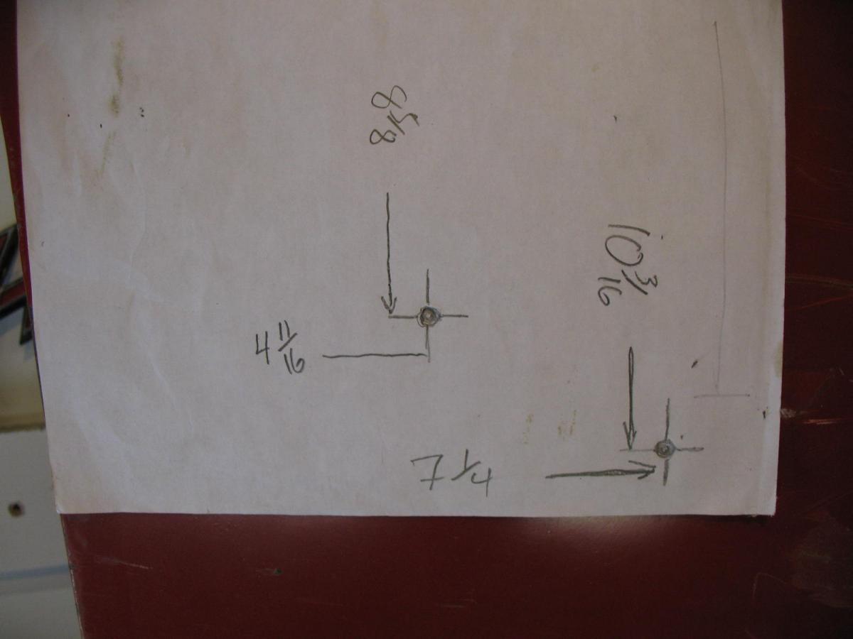

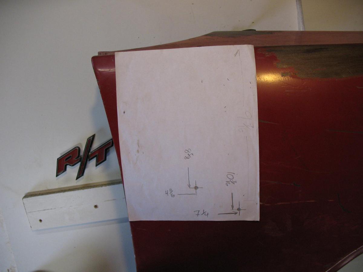

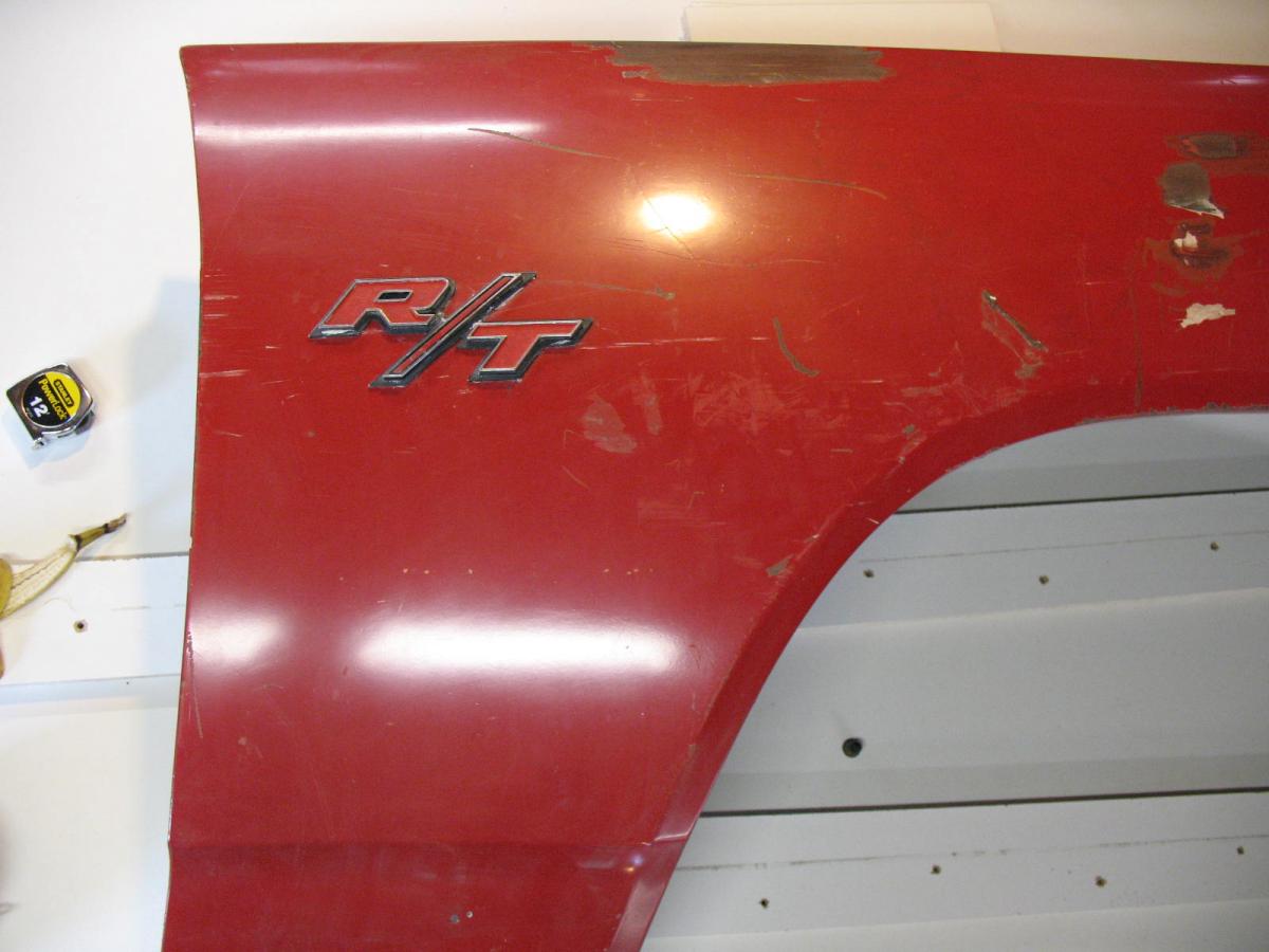

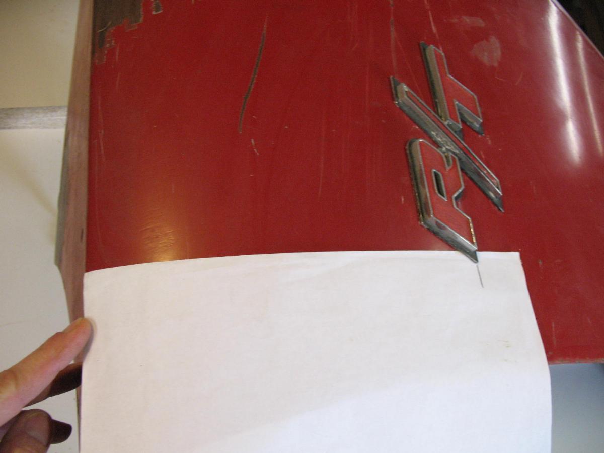

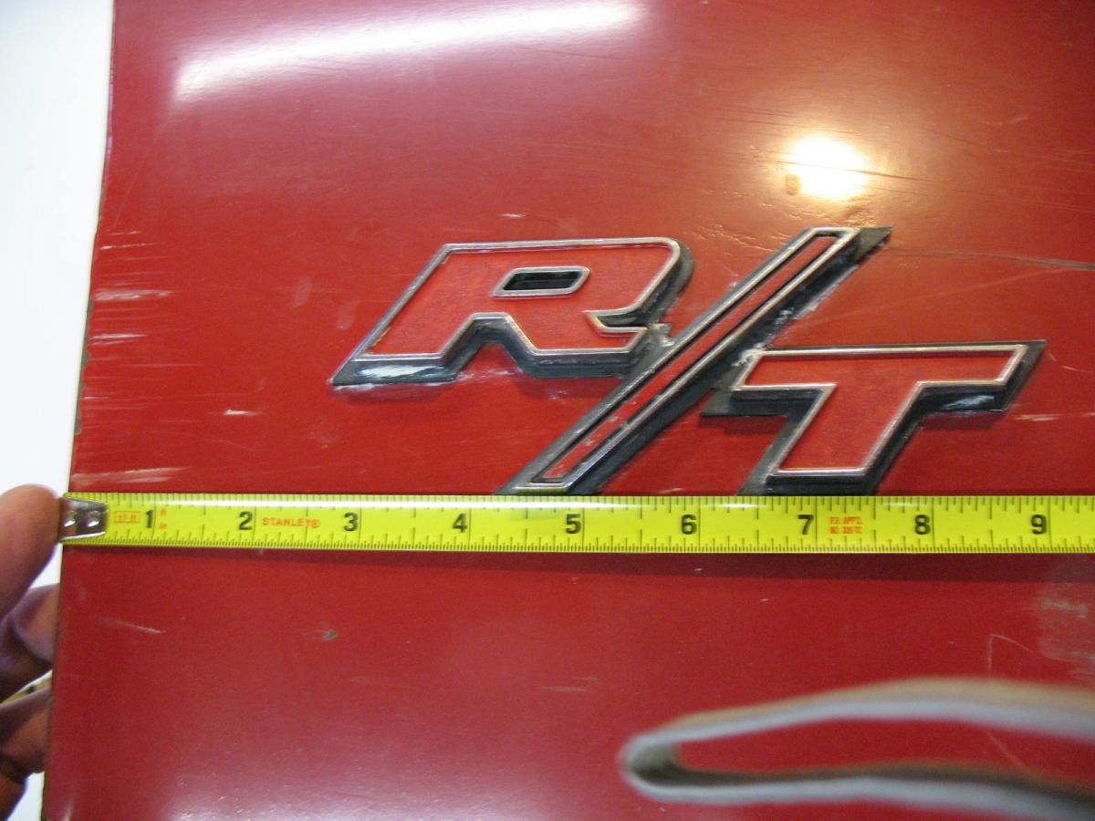

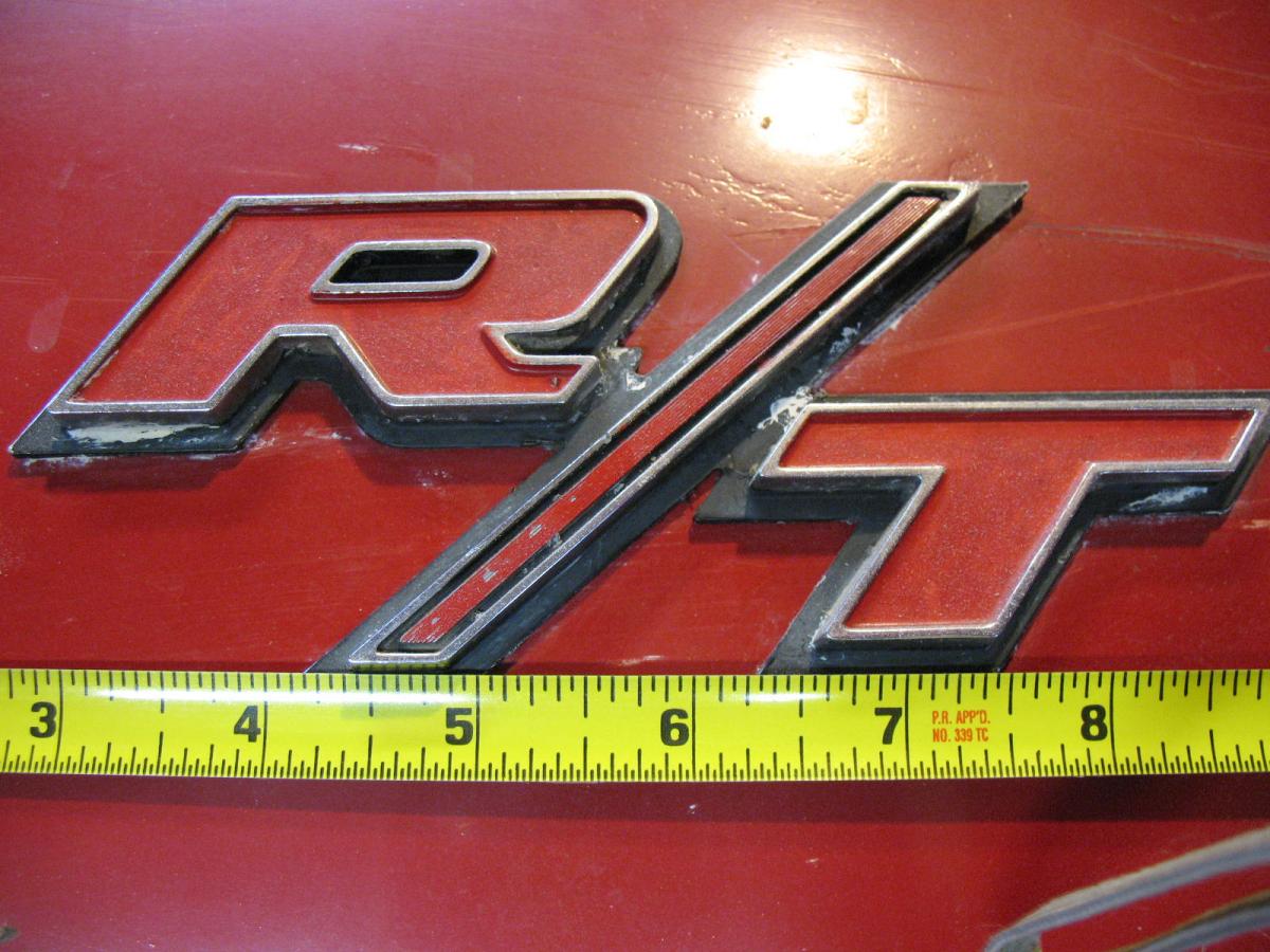

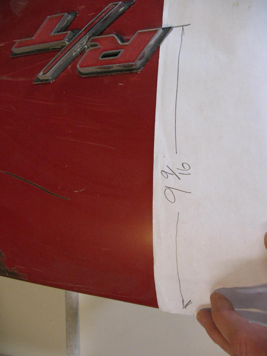

are there ant stincile kits out there for putting the r/t emblem on fenders correctly?i seen some on cras that i look so wrong?please help. thanks
How about this! I took these for a similar thread a few months back and I'll say the same thing I did back then, I am not 100% sure that these are THE correct measurements. I assume they are but allot can happen in 44 years!
