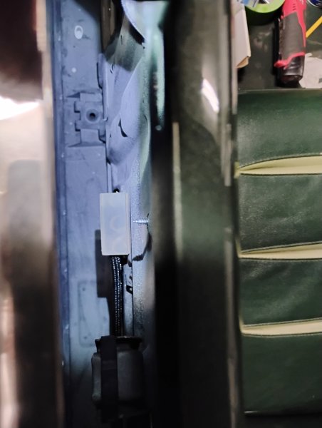

anybody have a picture of the front door assembly? Mainly looking for where different parts go. I have 68 service manual but the diagram does not show where some of the clips go, anti rattler, retainer, bumpers, etc. It would be nice to match the diagram with an actual door. Also, what are the 2 white pieces of plastic and where do they go? The picture below is not from my car but shows the pieces. thanks

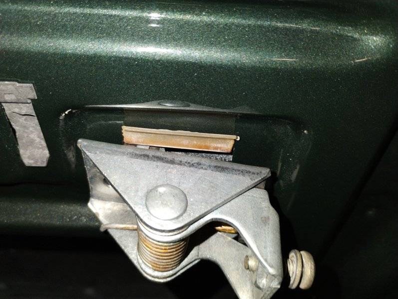

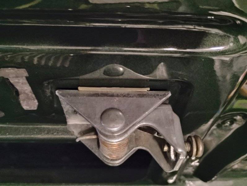

Do you own a fsm? There are some pretty good pics and drawings in there.

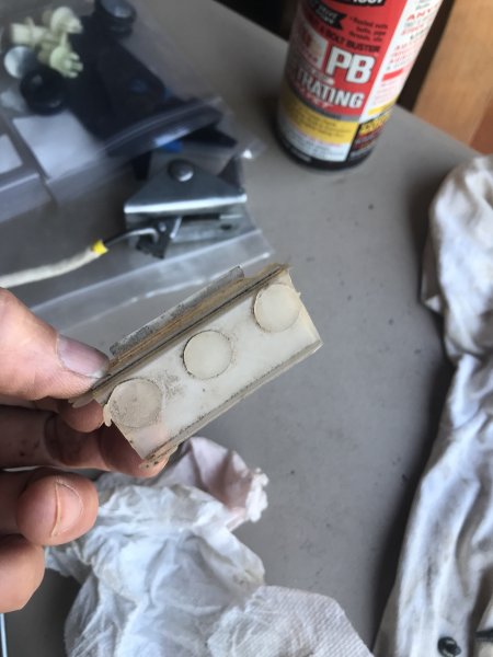

Thank you Davek for the photos (this confirms what I thought). I do have the 68 service manual and the parts manual as well. Does anyone know where the white plastic piece goes - shown below? it was in the front door.
