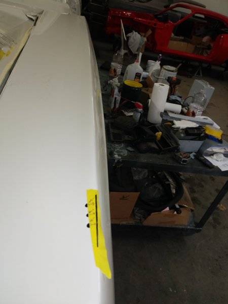

Looking for information or template on location of fender mounted blinkers. Need measurements and pictures or a template also need template or information plus pictures on the location of the gtx emblems that are located on both quarter panal. Body shop threw fenders and quarters away without measurements please help

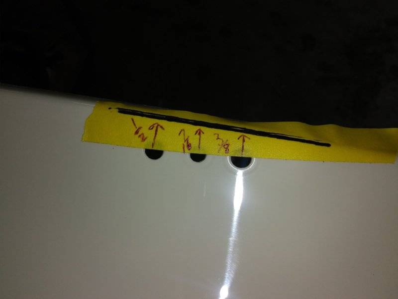

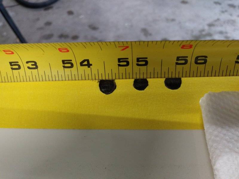

I'm headed up to the car on Sat. If you still need that info by then, let me know and I'll get it to you.
measured from the upper,outer corner at back of the fender....... also, my center hole is just shy of 1/4" and the outer holes slightly bigger than 1/4"; I'm thinkin 7/32" and 9/32".
