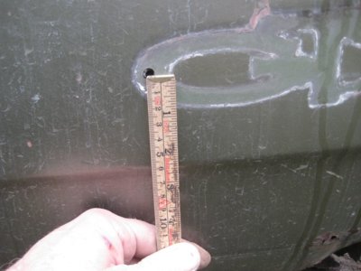

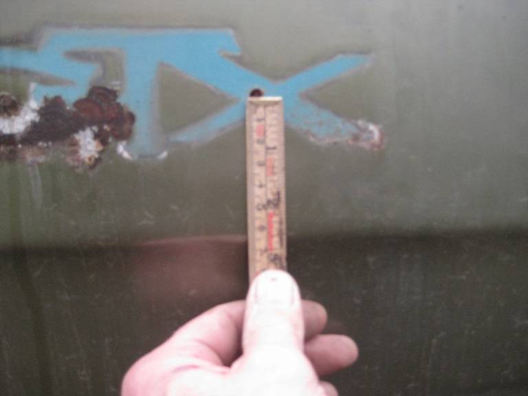

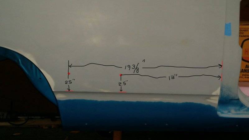

Need help badly, anyone out there have any templates or measurements and pictures of location for fender blinkers on a 68 HTC plus I also need template or measurements and pictures of location for the gtx emblems on the quarter panels any help would be awesome. Body shop threw out fenders and quarters without measuring HELP thanks in advance go mopar

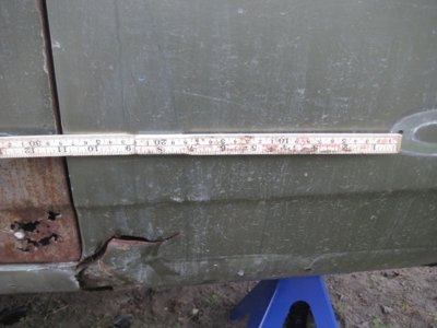

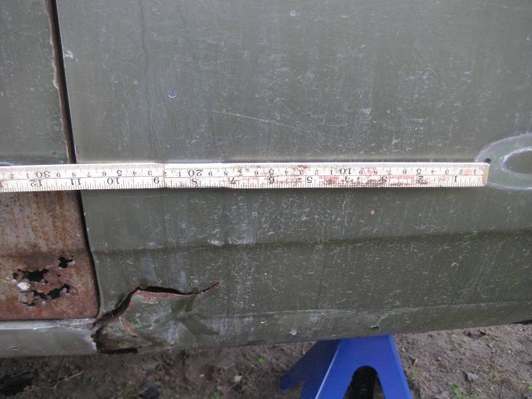

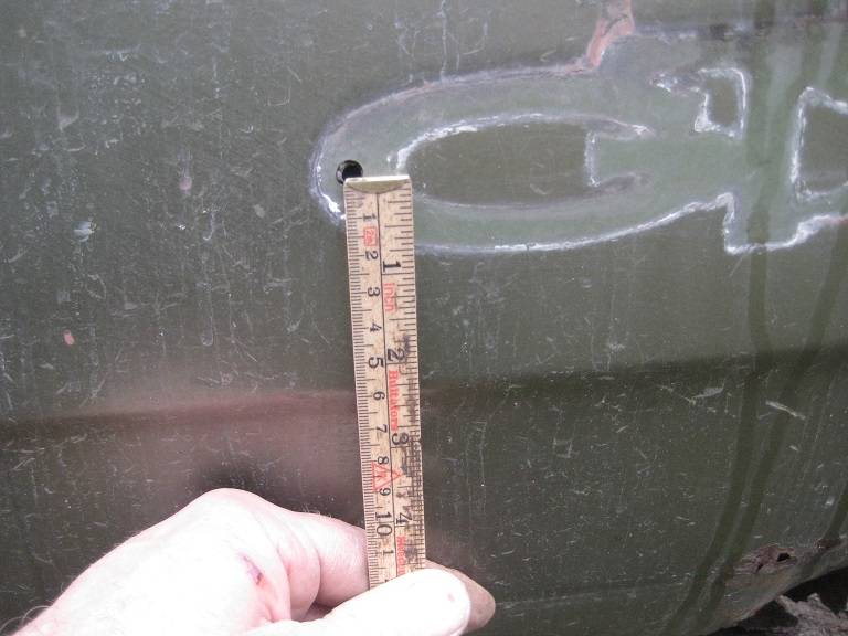

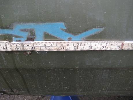

Here is the stock location on the Passenger side GTX quarter emblem.
Driver's side is identical. Measurements are taken from lower peak,
and door jamb edge. Best I could do with this free hand photo program!
From my 68, Theres a difference between right and left side in the height.

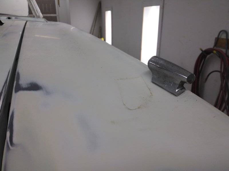

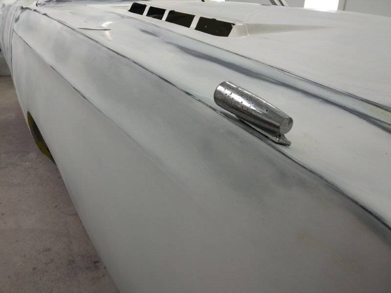

I'll get your blinker locations later today......
