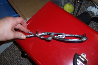

Hello. It has pins that go through the quarter panel. On the inside of the quarter panels I used speed nuts to hold them on. You can get at them from taking the back door panel off. You will have to drill these holes for they do not come on new quarters since GTX shared panels with Roadrunners, satelites and belvederes. I put dabs of clear silicone on the backside becuse you reall dont want the emblems metal part to rub from vibration and scratch your paint ( It works for me ).
