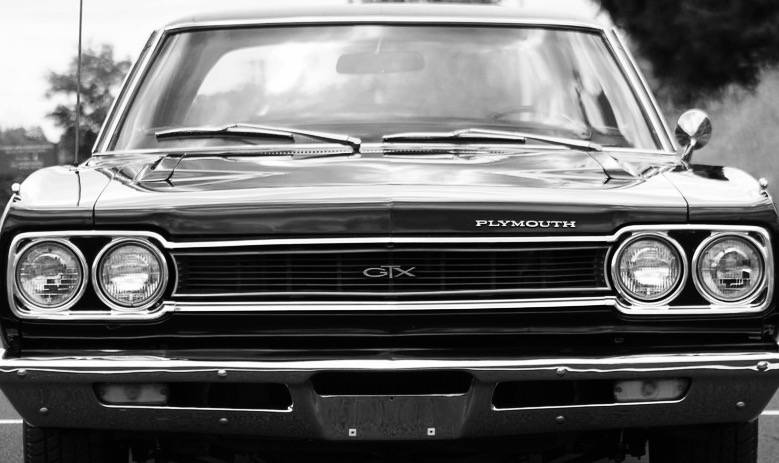

Here’s a picture of a 68 I had, I believe it was correct. Looked like it was never refinished. Black and white picture doesn’t help too much but at least shows where the paint was. Best pictures I have with me.
