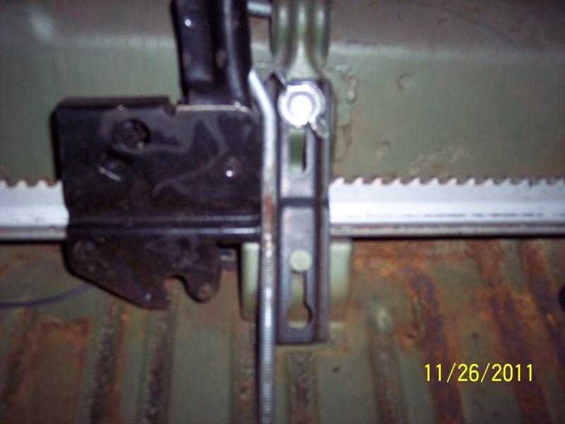

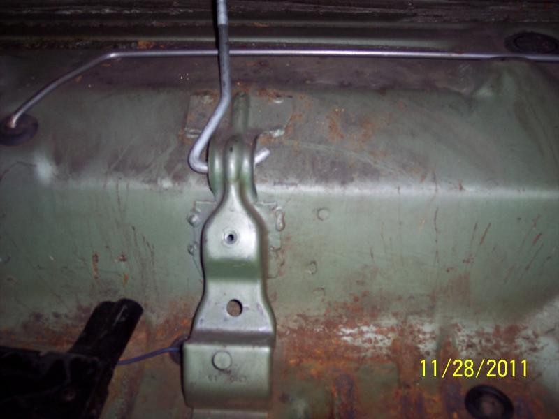

Here are some pictures of a 68 Satellite jack parts.
Jeff
100_8439.jpg100_8394.jpgView attachment 84381
Thanks Jeff, That is the same bracket I have in my trunk.

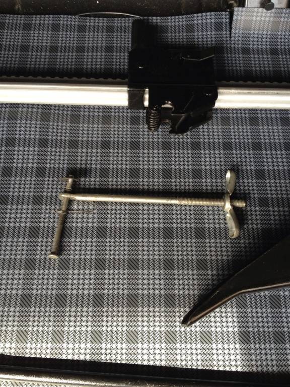

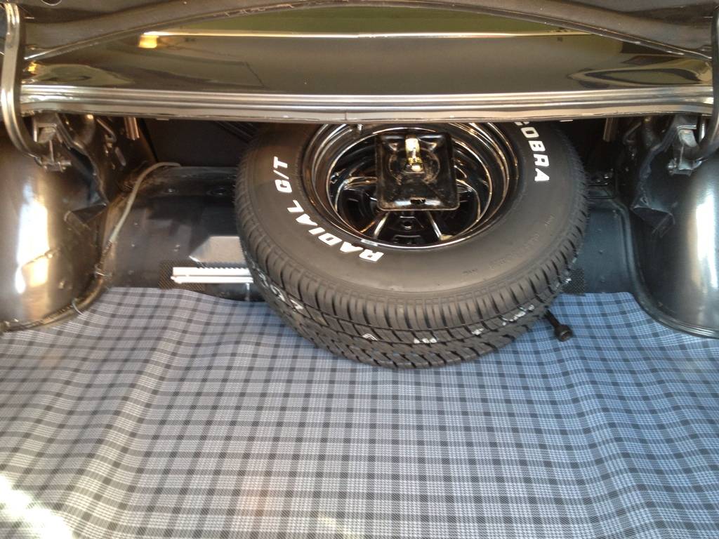

The holddown rod you have is for a 69,the jacks are the same for 68 and 69.The bracket in the trunk and the holddown is the difference between the 68 and 69.These are pictures of my 69 Superbee.The circled parts in the picture are the parts needed for the 68.
Hope this will help
Jeff
