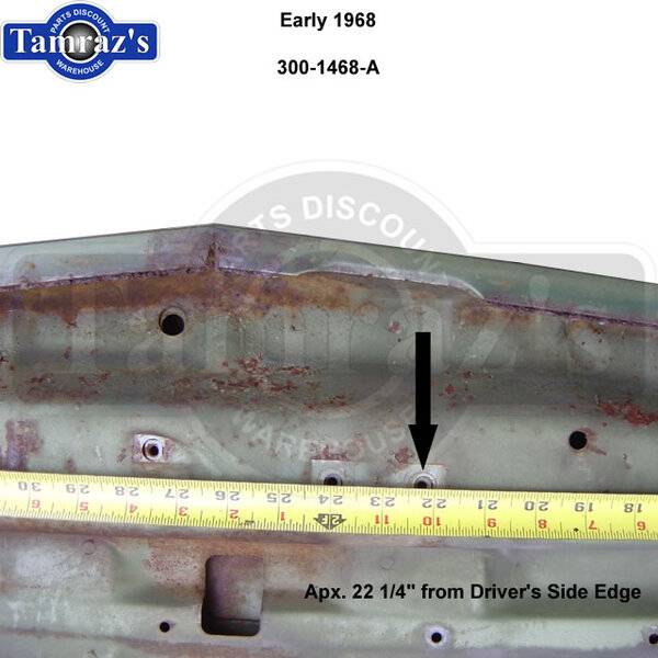

To add insult to injury, there are two 1968 hoods! An early model with the hood safety latch
in a different spot than the late model. You can't make it work unless you have the correct
sheet metal piece that matches the position of the latch!
Sorry, Yes, it will fit on a 69 Sattelite provided the latches line up. That means the hood is a
late 68 model and the 69 has the correct cross brace that matches the latch.
