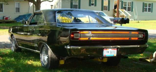

The tail panel on my '68 has been painted silver. From 30' it looks ok, but when you get up close, it's pretty bad.
Any suggestions on how to remove the paint without damaging the panel?
