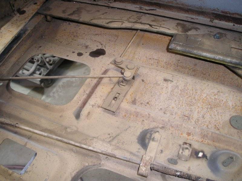

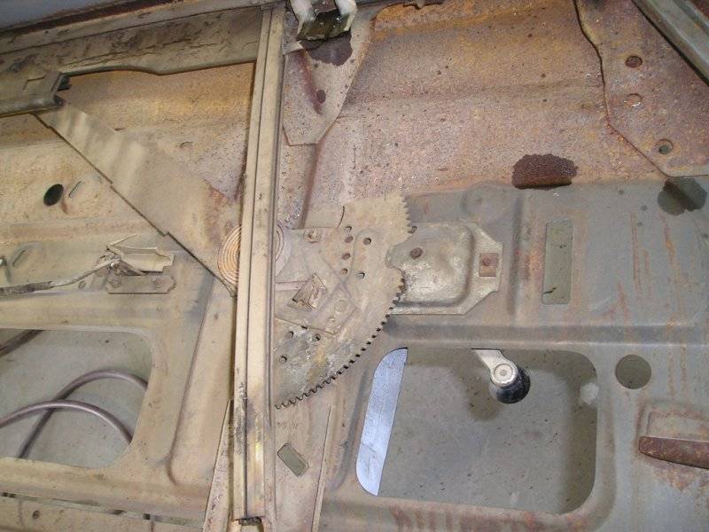

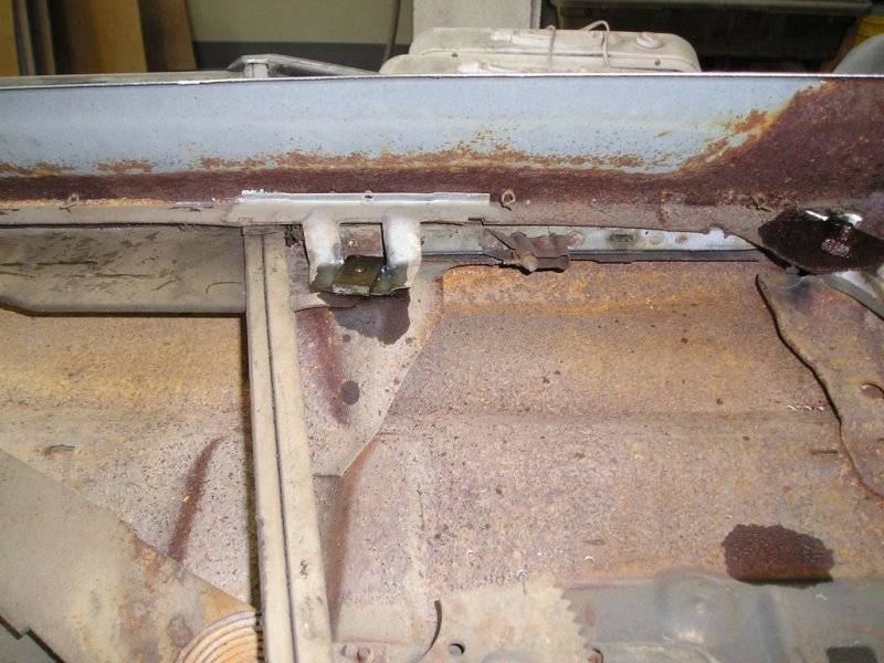

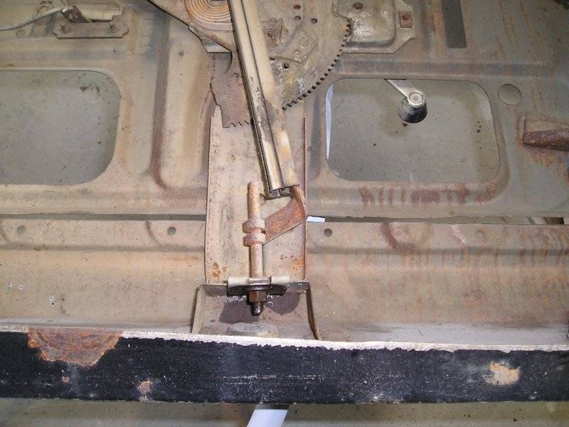

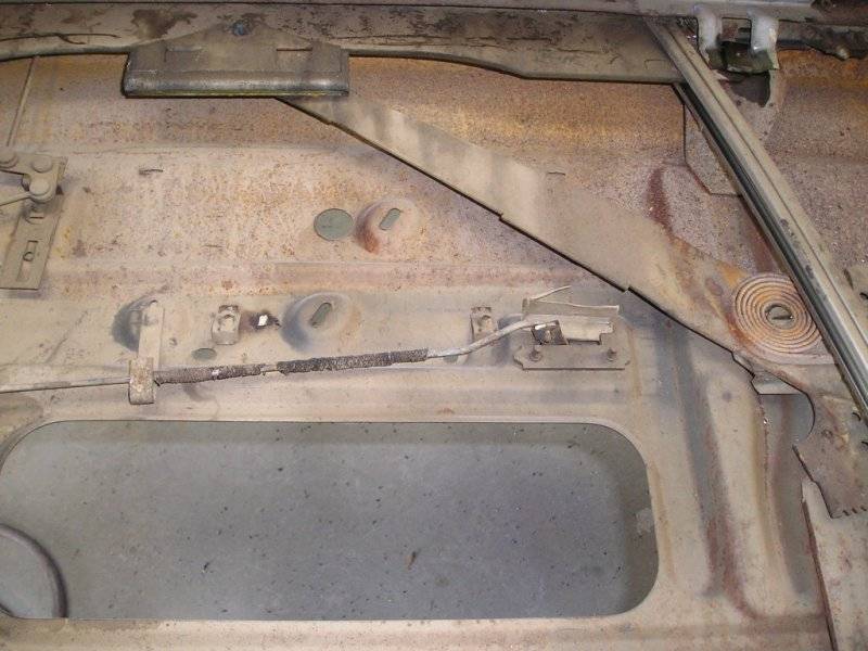

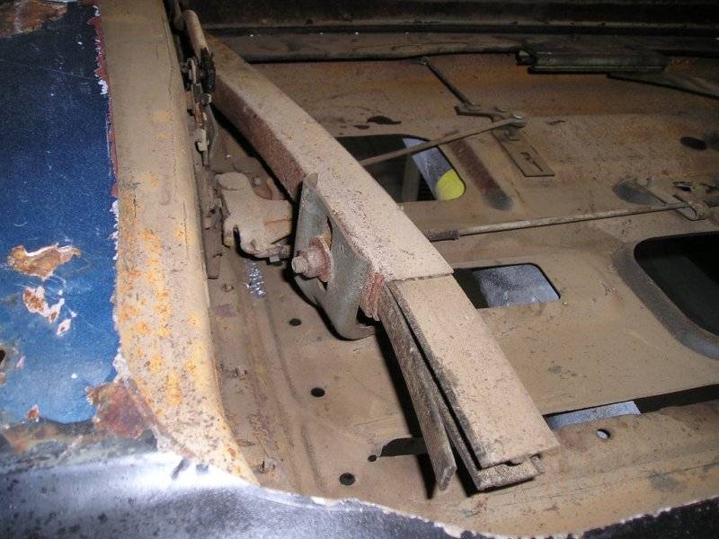

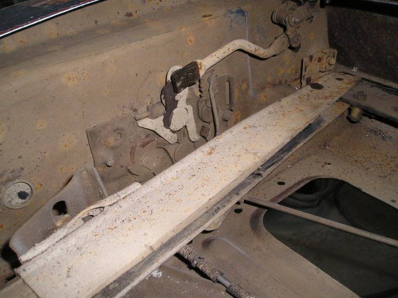

I was hoping you needed the rear assemblies due to the fact I have rear assemblies that I had cut out of a few parts cars years ago still assembled to the sheet metal. I don't have cutaways of the door mechanisms unfortunately.
Would you be able to post a couple of photos of the quarter regulators assembled to the sheet metal for reference?
