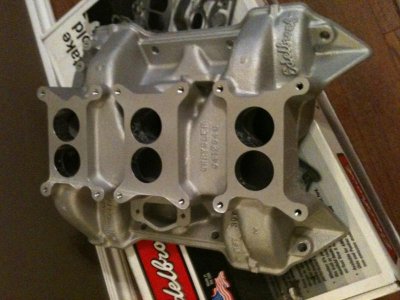

wifey got me an edelbrock 6 pack intake for x -mas, ordered carbs today, next payday will be air cleaner and then install kit,

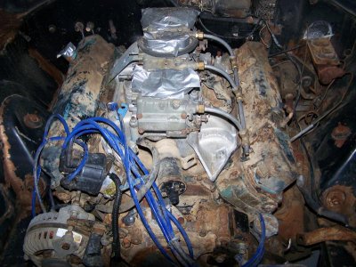

You said you wanted pictures, will this one do?
Also color of engine bay were they painted body
color or black?
color or black?
Thanks
That engine must have been clean enough to eat off from...
And then you made thanksgiving dinner on it and threw up all over it.:icon_puke_r:
Oh, and, engine bays were painted body color.
it's actual quite clean on the inside, need to be bore as it has a lip, but no sludge in sump no crap on pistons, the only problem with the engine (other then the lip) is number 7 right hand side push road is bent. However no damage was done, due to lip i am rebuilding the engine.
You might want to switch the valve covers from side to side when you're putting it back together, it'll make the breather hose fit better.

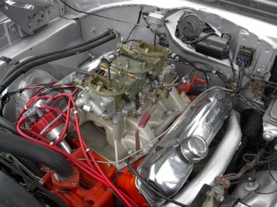

My 69 Bee....original 383 car...6 pack fit fine..even with stock hood but switched out to 6 pak hood later

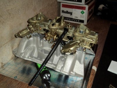

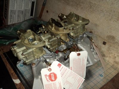

update!
got some carbs now [/ATTACH]
