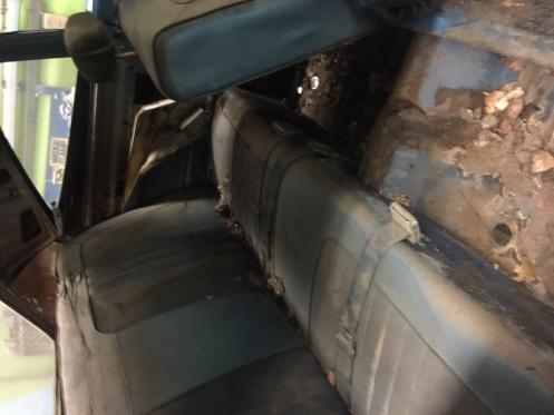

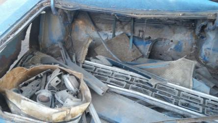

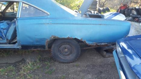

I figured I'd keep track of the car here. This is my first mopar project. The car is a 1968 roadrunner qq1 4 speed car.
Quarters, trunk pan, extensions and wheelhouses have been ordered.
Welcome to the madness of restoring a car! Take LOTS of pictures before and as you disassemble things - you'll thank yourself later!
Best of luck and keep us posted with progress...
X2, what he said.. Nice RR! Doesn't seem to be in too bad of shape.
Thanks guys, not my first resortation, just my first mopar.
Love the new thread. Love RRs as well. Welcome to the site and thx for letting us follow your progress on the restoration.

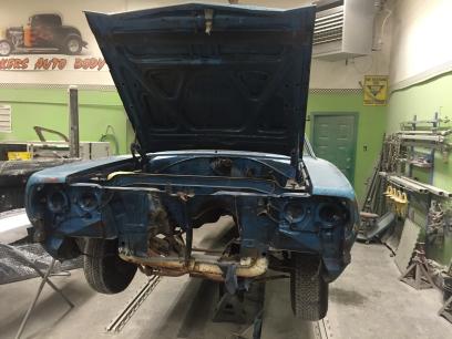

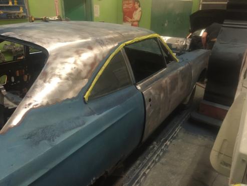

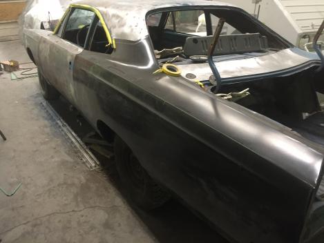

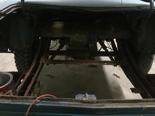

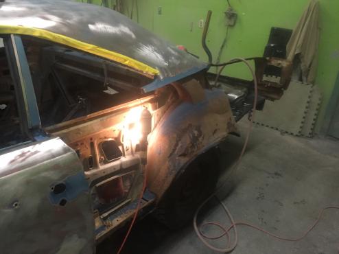

And it begins. Contemplating mini tubbing to get some decent meats on the back.
It's getting uglier by the day.

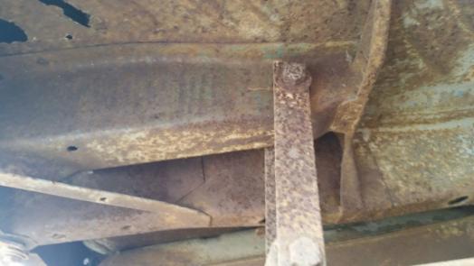

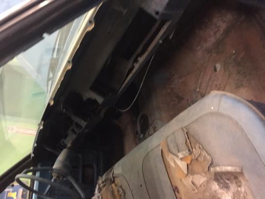

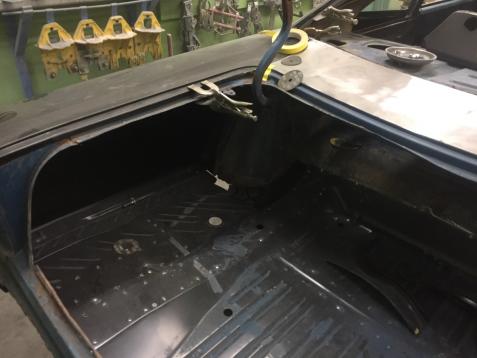

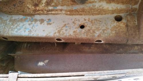

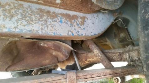

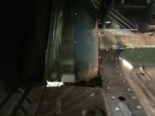

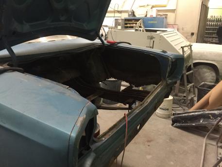

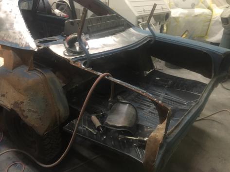

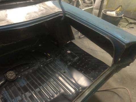

Starting to put back together. Inner rocker was Swiss cheese as well. Looking forward to putting the mock up 440 in place and start plumbing the twins.
I like the protouring/pro street look. The kiwi nailed it with the orange car, it's a beaut.
