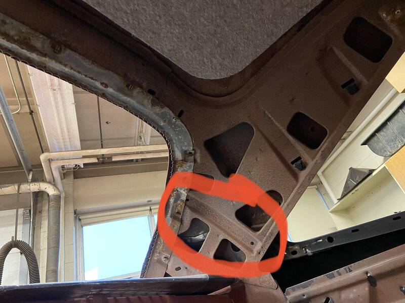

WTB 68 "Super Bee" rear headliner teeth on C Pillar? See attached PIC

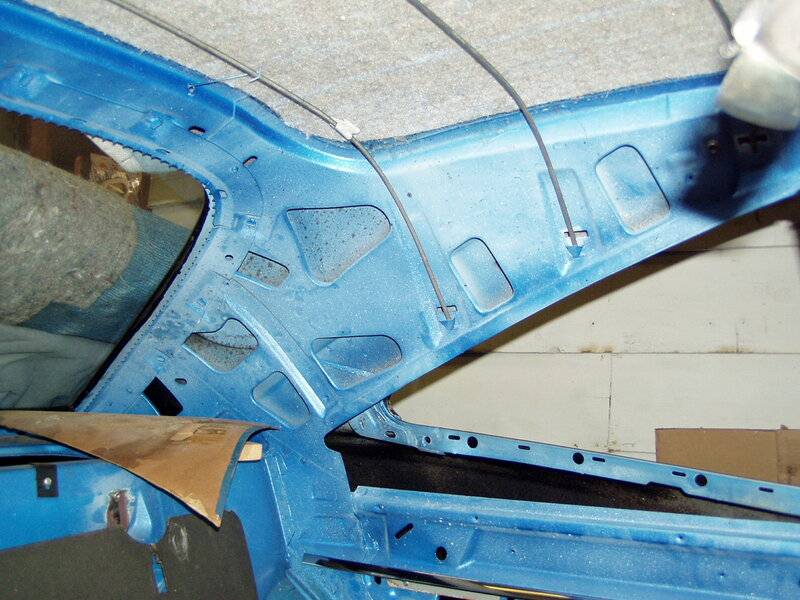

In search for this, which I'm told in my thread build I am missing. Don't know why I'm missing but I am.

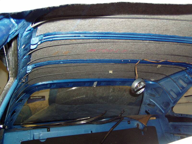

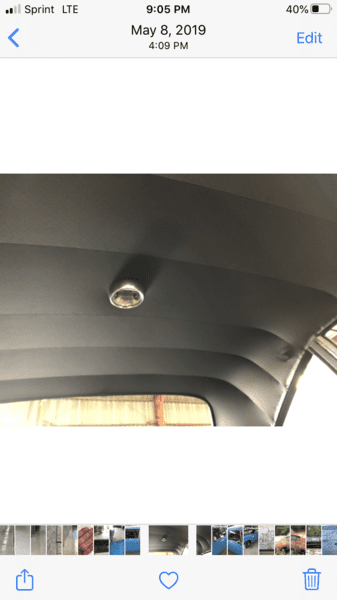

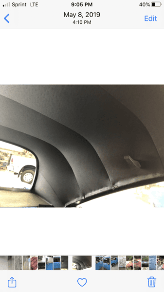

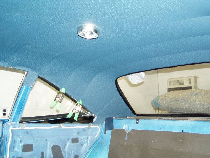

The 1968 does not have teeth in that spot. The headliner goes down to the rear package tray. There is a cardboard panel in that spot that the headliner goes over. In 1969 it was changed to teeth in that spot.
1968 Superbee headliner installation 002.jpg 1968 Superbee Headliner Installation 007.jpg 1968 Superbee Headliner Installation 011.jpg
As stated in post #8 the 68 model doesn’t use them, the liner passes this area and attach’s down on the package tray. So when you purchase your head liner be sure you tell them 3 times that it’s a 68. Don’t ask how I know this.
