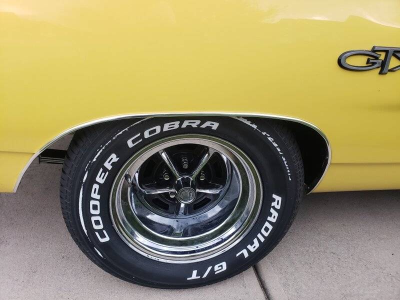

I'm switching to the classic Magnum 500 from year one. 15x7 on front. any advice on putting 15x10 on rear. what spacing ??

The bigger the steel wheels get the heavier they get. Like over 30 pounds EACH for 15x8. This just lowers the performance of your engine and braking system. Plus look at the wheel above, it looks awful with how deep set it is.

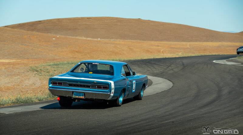

I have a 69' Bee, and I'm running a 15x10 on the rear of my car. 5.5 backspacing with a 295/50. My car has HD springs with a small lowering block. I had the slightest bit of rubbing on the inside of the wheel well. Only under hard cornering though. I added a small 1/4 billet spacer for at the track and couldn't be happier with the large rear tires. Coronet/Super Bee's have huge rear wheel wells, you can stuff a big tire in there.
