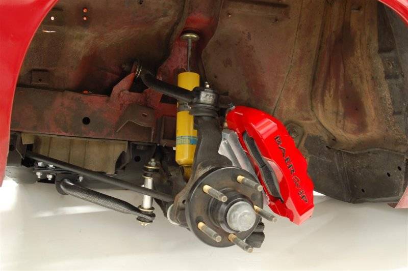

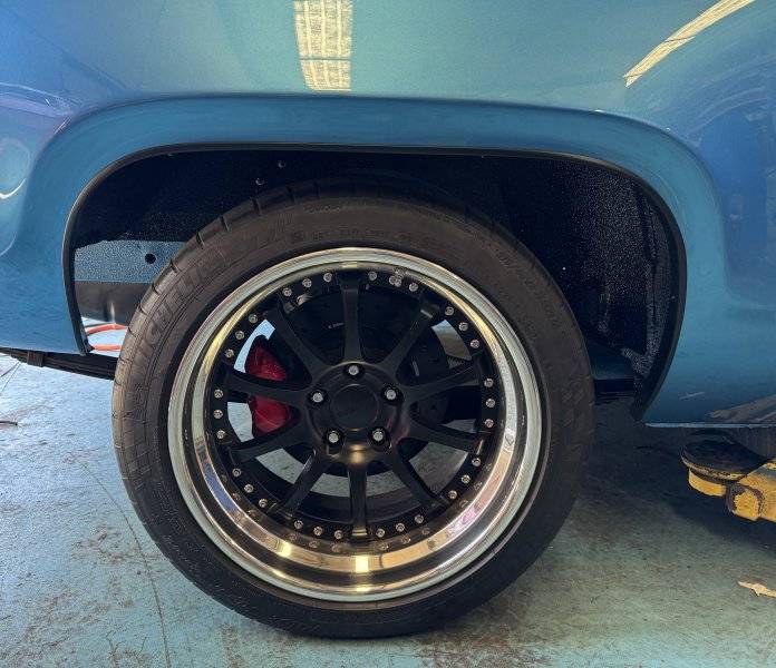

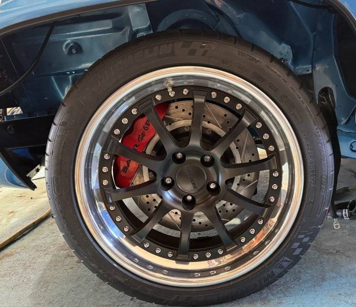

I am currently using Baer 6 piston pro with 13.5" rotors & 73 spindles using Forge line 18" ZX3 rims with a 4.5 Offset no problem 4 piston would be heaps the rear of the rim is parallel with no step all the way to the centre spokes
HEMIB, how wide is your rim?
The next part of this is getting the wheel fitment sorted out.
I’m going to use a 17x10 w/6” B.S. and a 305/45R17 on the rears but I haven’t focused on the front yet.
