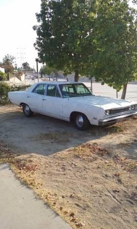

By any chance is this the car you're considering(see pic) ? Picture is of the Craigslist ad main pic. Don't worry I'm not trying to buy it just wanted to know. Because the seller was non responsive of my attempts and I gave up.

Yep that's the one. Well I hope he responds but it's likely already sold then. Either way good info and I'll keep looking. Complete 4 doors are way more in my price range right now so I was planning on daily driving it for a while till I had some room for another project.
