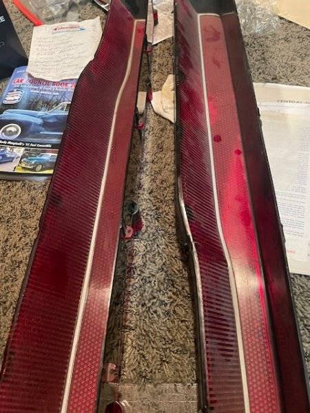

This is the area of the bezels

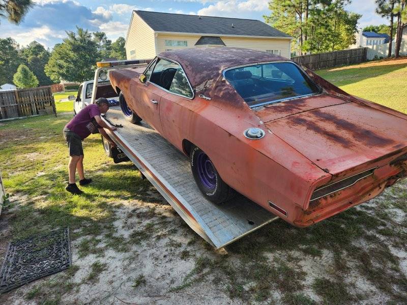

All 69 Chargers had the chrome bezels and silver stripe on the lenses. 70 Chargers had different lenses with reflectors and no stripes painted on them. Base model 70 Chargers XH vin, had the chrome bezels like the 69 Chargers,see Dave's picture above. All other 70 Chargers XP/XS vin had the reflector lenses with no chrome bezels,because they had the aluminum finish panel surrounding the taillights. My mom's 70 Charger R/T SE shown in the photo with the rear finish panel trim.

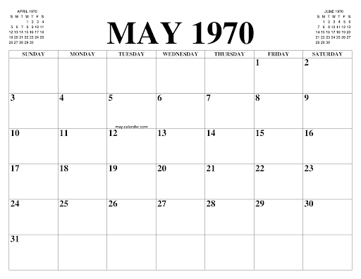

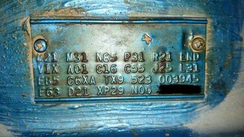

The SPD for my car was May 23, 1970

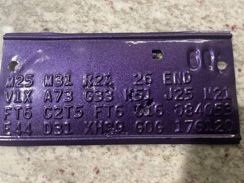

My tag has a rot spot on the month, but it’s May 16.
Yowzer, the last six digits in my VIN are approximately 53,000 higher than yours. That's a bunch of cars in a one week period. I don't know if they produced other models besides Coronets and Chargers in St. Louis.

I removed the chrome bezels from mine. They’re actually in excellent shape and would clean up nicely with a light polish. I’m going to hang onto them in the event I ever acquire a ‘69.
