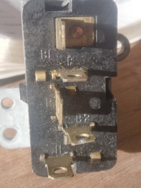

I edited my post 4. The wire off the switch feeds the front park lights and it goes from the switch to bulkhead terminal U.
Interesting! Diagrams posted at MyMopar for Dodges shows a small jumper wire between rear and front parking light circuits at switch/plug!
(hence why I don’t trust completelly on those diagrams LOL)
