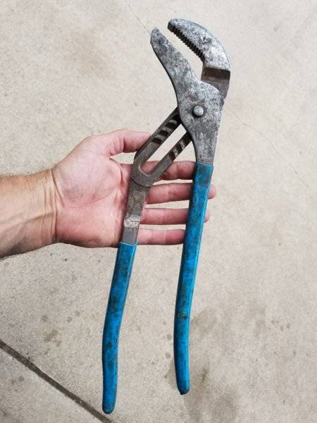

Channel Locks. You will need a couple pairs of the larger ones.

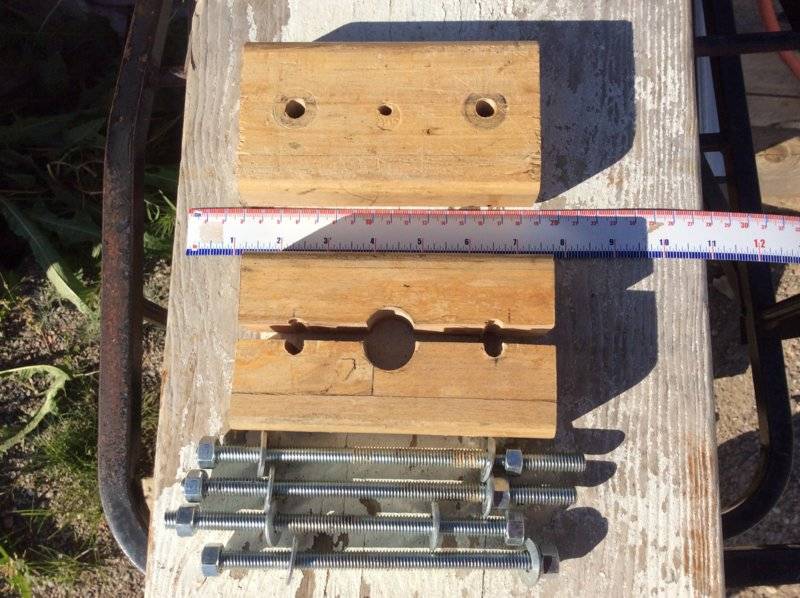

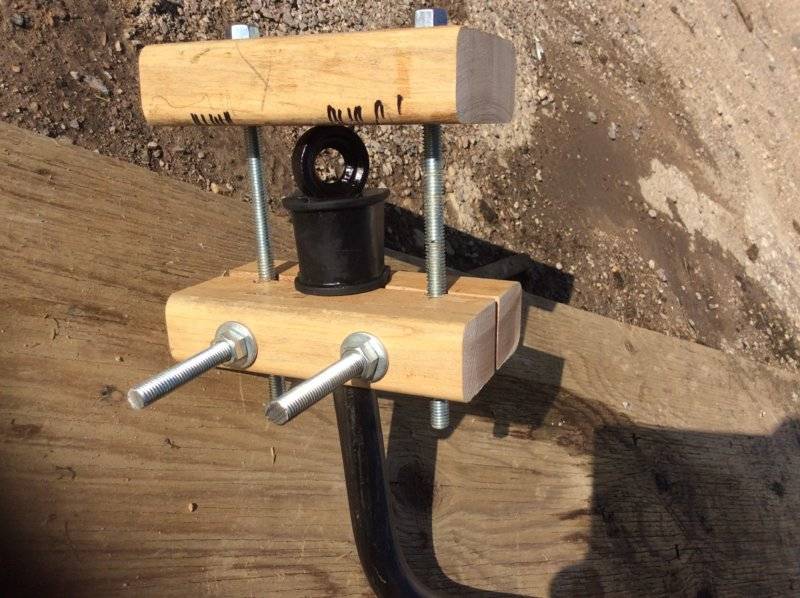

Not sure if this is any help to you but I made this press out of some scrap wood and reddirod. I used it to press my old bushing off and the new one on. Worked slick. My bushings from PST fit my old brackets perfectly.

As hunt2elk replied, they can be pushed into place using pliers. I have used a larger set of vise grips and pair of channel locks. Coat them and the bracket with some grease and pop in place. Some are easier than others, but had rather fight with one vs having to cut and reweld.
