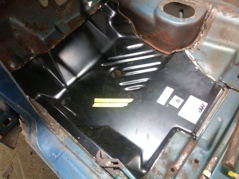

Does anyone,with a 69 4 speed, have their interior out that could take some pics and measurements of where the shifter hole should be, approximately. Someone previously just hacked the crap out of my hump area. They added what looks like a E-body 4 speed hump. So I just want to make sure it's in the ballpark. It had an auto console in there at one time before the Hackery. So far I’ve had the floors and correct 4 speed hump tacked on

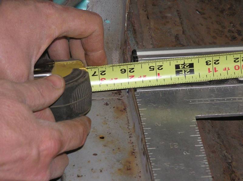

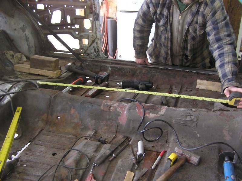

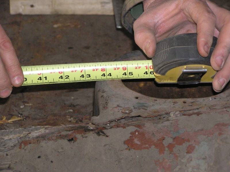

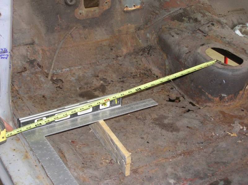

Here are some pics with measurements that I took of my car before tear down. I hope they help.
the proper four speed hump sits in the contours of the floor pan without a ton of wiggle room locating the hole in the proper spot
