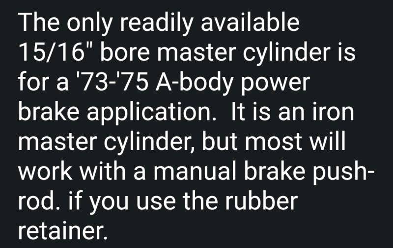

As @Kern Dog said above. I personally like the "feel" of manual brakes. You can get a cast iron 15/16" one for a '74-'75 A body. Also leaves more room and less clutter in engine bay. From Cass/Dr Diff on the master cylinder.
