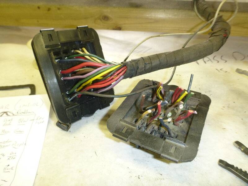

All depends on the condition of the existing. I just replaced the bulkhead connector and all the wiring ends cut and recrimped..
