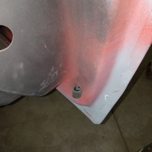

Here are the loose fitting bumpers

I know I will have to make the slot smaller to hold the bumpers tighter, other wise they will fall out.
Just wondering if they should be that far away?

My DMT bumpers fit perfectly. But I have original doors and quarters.
Pretty certain if you adjust the striker that should be all you have to do.
That is odd at how loose those bumpers fit. I have the same ones in my cars and they are snug.
