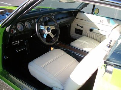

i am going from a black interior ro white on my 69 charger and i need to know what should stay black and what should go to white,obviously the dash and all related dash pads and glove box door are to remain black,and the seats and the door panels and headliner should be white,but what about the rest?if anyone has pictures that would be great also
Basically the seats, door panels, headliner, & sunvisors are white, everything else is black.
Hope these pics help.
Good luck!
