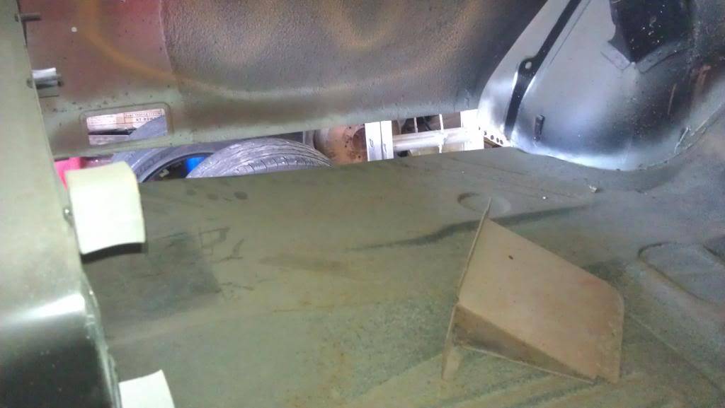

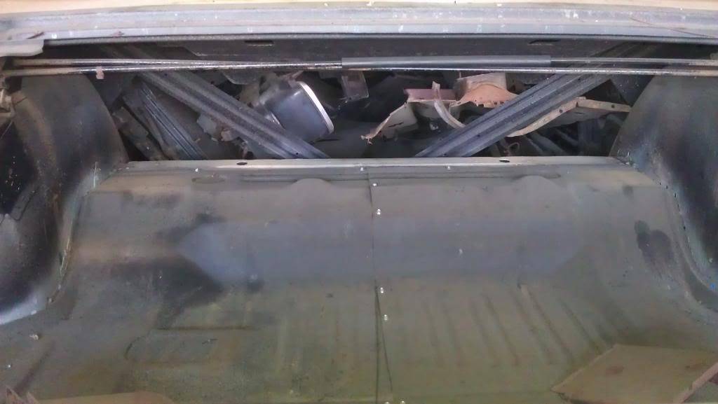

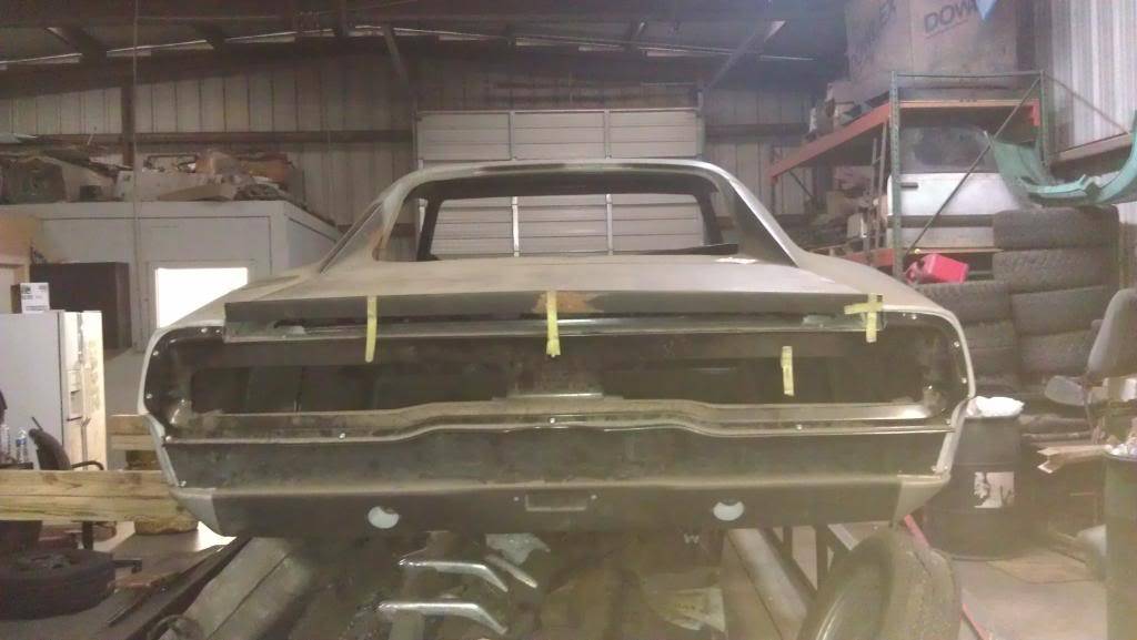

I picked up a project mid way through panel replacements, new front floors,rockers have been done. the rear truck floor is not welded in or tail light panel and lower rear quarter wheel wells.
My buddy had it on a stand, he originally had it on rotisary. But was worried about body flex so took it off. I have it on my lift currently, but was wondering if I can put it back on rotisary or even put front and rear suspension in and set it down without hurting it?

Welcome! Looks like a great project. I don't see no issues with dropping her on the ground being the floor pans, rockers, roof and torsion bar crossmember are all solid. Myself I would put jackstands forward of the hump, get her level and start taking measurements. As far as the rotisserie, I would be pretty hesitant to put the car on that yet, being it would mount to the rear rail flats and there is nothing supporting those in place, seeing the back pan is out and the rear tail light panel is not secured to anything.

you are going to be fine. hey you had the smarts to ask before putting it on a rotisserie i agree with prop there is not much supoting the rear frame rails right now i waould put it on stands level it up and put the rear pans in for sure. good luck
thanks for the input guys, at the moment it's on my lift supported at front sub frame and rear right in front of spring mounts. Going to do as suggested and put suspension in and put my I-beam under it and level it right in front of rear springs.

Just an idea, but as long as you got that trunk pan in there and it's where you want it, use a marker or a spay can of light colored paint and mark all the edges of the frame rails and shakle mounts. That way when you pull it back out you'll know where to drill all your holes for the the spot welds next to.

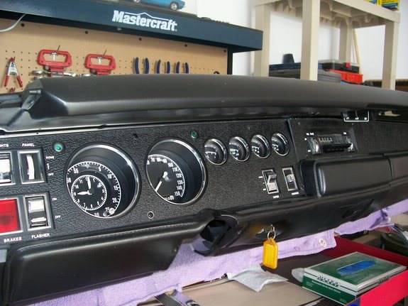

If somebody may please scan Charger's tachometer and speedometer.sorry for my English
