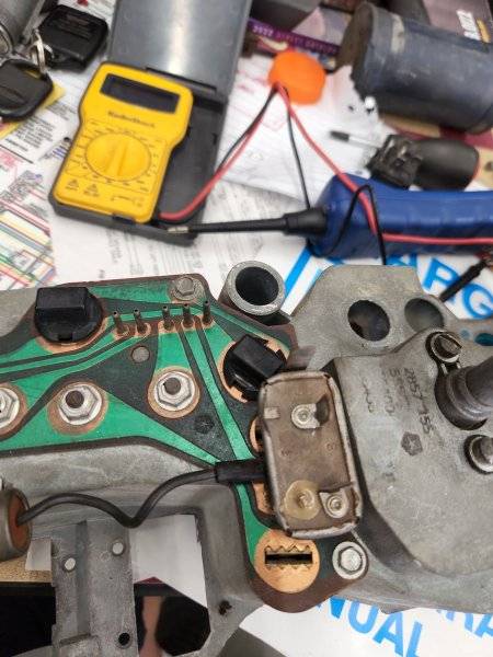

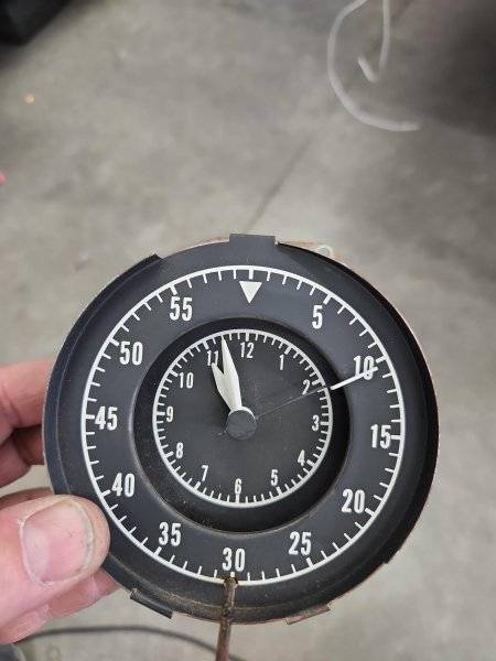

Trying to help a friend with his first B Body. Bought the car half completed in boxes. I've never owned a B Body with a Rally Dash, so I can't help him much.
See picture of tic tok tach. It seems the 12V terminal is missing? Am I right, or is it one of those "barrel" pins missing? Any help appreciated. Take care.
Wow. Don't I feel stupid. Like I said I've never had a B Body with a Rally Dash (or obviously a tic tok tach). Appreciate you setting us straight.
Wow. Don't I feel stupid. Like I said I've never had a B Body with a Rally Dash (or obviously a tic you tach). Appreciate you setting us straight.
Don’t feel bad it happens more than you would think :thumbsup:
Trust me confusing as hell when you look at it and they aren't side by side or you aren't super familiar with it. It's even numbered in the style like a tach would be so it gets to messing with your eyes.
