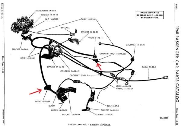

I need a cable and my car has cruise. So I know 61 to 63” is the general concenous when getting the right cable. But I’ve seen options without cruise control. Is it the same 61 to 63” when with cruise? Thanks.
Need someone with a parts book. 68 and 9 are the same.
If you cant find anything i can maybe pull mine and measure it.
I see, so it runs through the cruise first then into the car. That would make sense since I’ve seen some options out there for top and bottom cable... I might have to just pull mine out to measure if no one has info on it. Thanks for the reference.
Well I found one on roach auto. I found an nos cable was 36” this was 40” and only 8 bucks lol. The bottom is 63” I guess.
For what it's worth, I did find that the lengths are slightly different cruise vs. non-cruise on my 70, but close. I guess you need to make sure which of your two cables is bad too (speedo-to-cruise or cruise-to-trans). I also found that if you're 2"-3" too long, it's fine, but if you're 8" too long you can have cable kinking issues. Too short obviously won't work. There's a guy on ebay that sells a whole bunch of repro cruise control mopar cables, so maybe that's worth a look.
