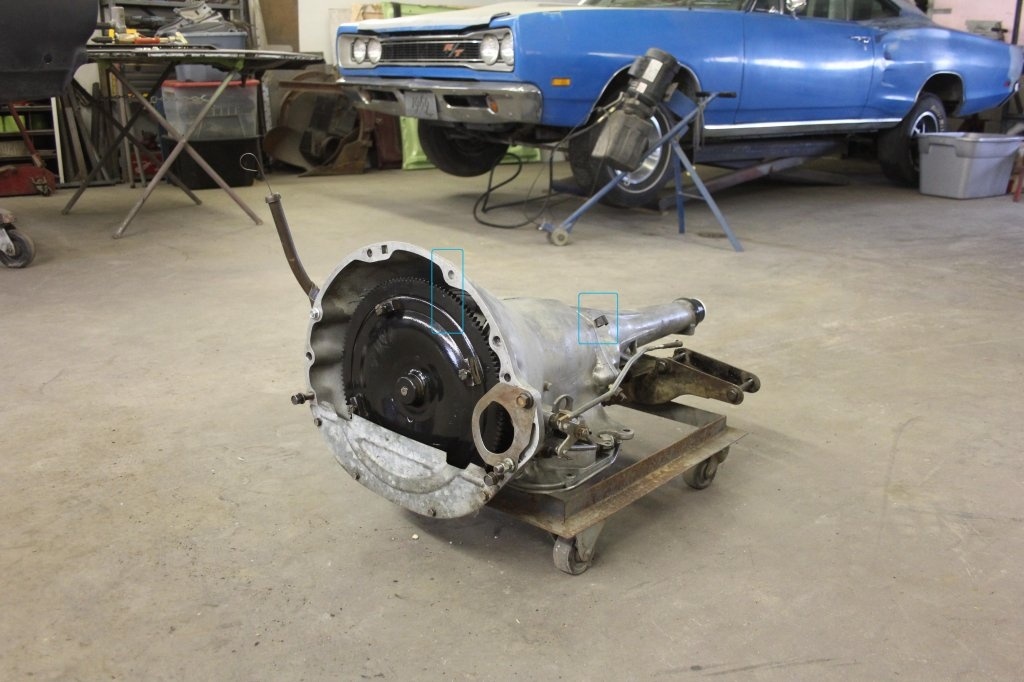

I installed the backup light wiring harness from the firewall to the neutral safety switch on the automatic transmission (That was a royal pain since I have headers. Sometimes I wish I had an Ant Man suit.).
Is there supposed to be any clip along the way down for the wiring harness?
Pictures would help me figure it out.
Thanks, FBBO
I didn't find anything when I installed mine. I just used the engine harness tab on the firewall and made sure the slack wasn't interfering with the transmission linkage.
if I remember correctly. there are two harness clips for the back up harness. one is at 10:00 position on the bell housing. and one is at 10:00 position where the trans tail bolts on. I have circled the correct positions they are to be installed. the bell clip is not in pic.
