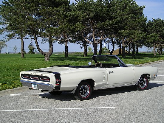

Hey Doug,
You can count the 58th one now........
A customer of ours was here just yesterday with his WS27L9G A4 silver 69 Coroner R/T convertible, had a white interior, white top, console auto. It's a work in progress, he has the number matching 440 rebuilt and all the body and paint work is done. Now he's finishing up the interior and trim and getting the top replaced. He's a pretty happy camper to have it in running and driving condition!!!
