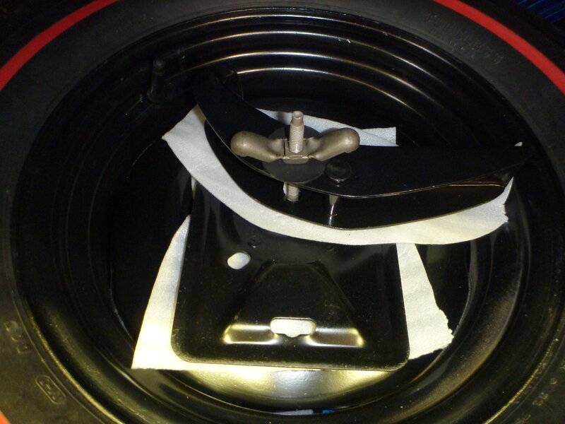

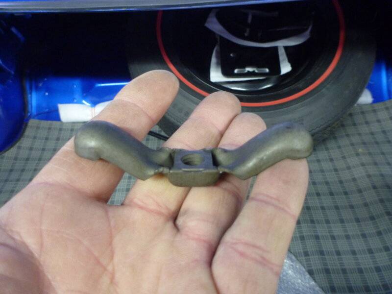

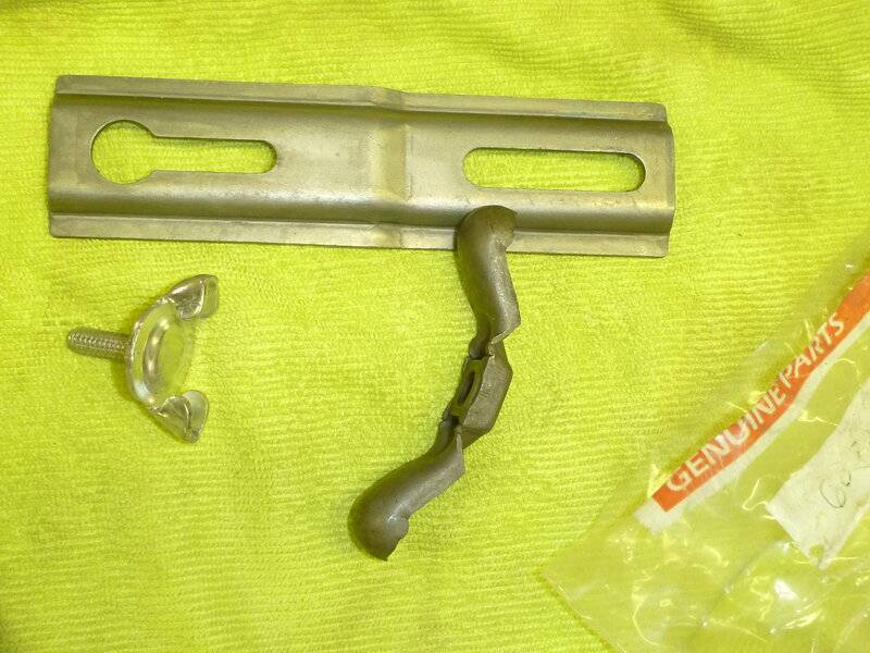

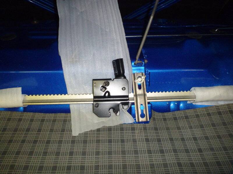

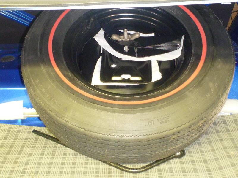

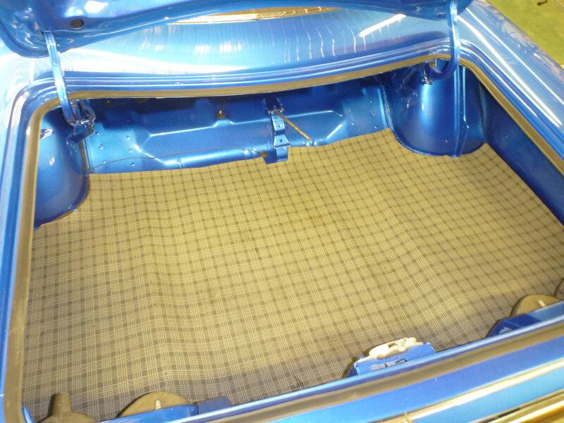

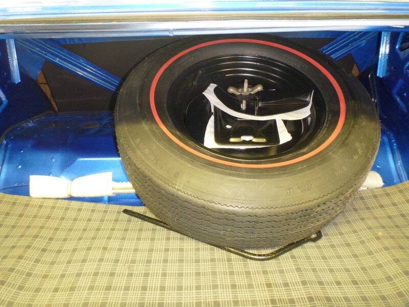

Could someone show me the correct way to stow away the jack mast, fittings, tire iron, and spare in a 69 GTX. I believe I have the correct hardware and jack, but things don’t seem right, and my memory is failing me.
My Bee, but same thing. Of course Ma Mopar used no foam...

Thanks! I was on the right track, and the foam around the mast answers my biggest doubt.
