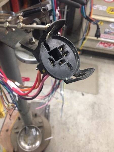

I am rewiring a 69 Ply wagon and am currently working on the ignition switch. Some one pulled the power wire out of the housing and thus damaged it so that the tag on the new connector cannot "grab", so the connector just pushes back out.
Does anyone know of a source for a new housing or even have any ideas on how to repair or fix something like this? Normally I just replace the plastic housing with one from a donor car or buy a new one if repoped but this does not seem to be available. Of course I could just attach the wires individually but I really would prefer not to do that.
Appreciate any ideas or leads.

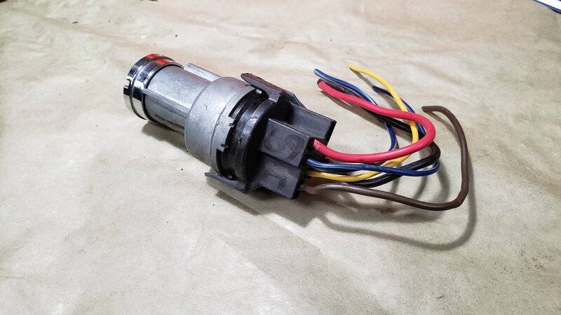

Post a picture of what you need, I have some pre-’70 ignition switches, some with pigtails attached. Relatively close to you it appears.
So I was about to get the terminal into the socket and stay but it is not holding the terminal where it should be. If I could find another one that is better I would definitely rather go that way.
Here is a picture
