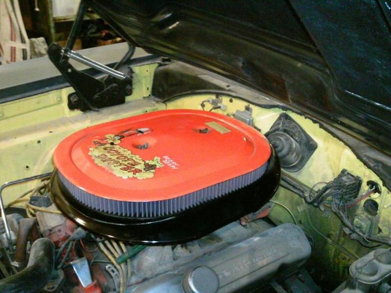

and FYI...you don't need a three speed wiper motor for the big air cleaner.......
I am, I just always heard that if you wanted the Coyote Duster air cleaner, you needed to swap to the three speed wiper.
If your going too use the whole AG set up with its added ductwork your going too need the 3spd motor. If all you wanted too run was a big 69/70 Coyote Duster Air cleaner you can slide by with a taller intake or add a carb spacer under the carb too gain some clearance so the rear of the air cleaner base gets over the 2spd wiper motor.
I had this issue using the large Coyote Duster in my 69 RR with a 440, I can't see it fitting any better with the 383 low deck.
