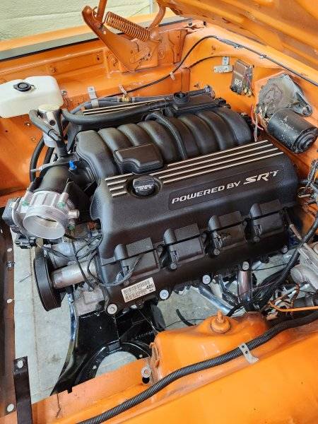

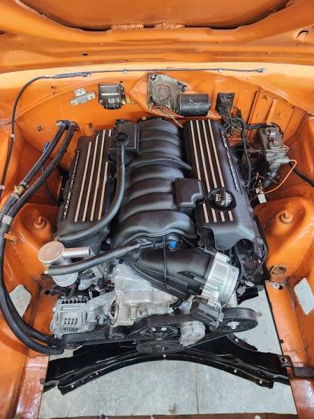

Thinking of selling car as it sits. It's a true 69 Roadrunner no fender tag. Was an auto 383 car now a has a 2019 Hemi and 8hp70 trans in it. No it's not finished and doesn't currently run. This is not my first swap and it will not be hard to complete. These swaps aren't to bad really. Has USCT cut out on K member to allow use of stock hemi pan. Holley engine mounts as well as holley trans mount. Has new tti headers as well as new manual steering box. Car is solid except rear quarter have some mud in the lower sections and around wheel lip. Interior is good front seats just got new covers and foam. Take 38k no less title in my name. I'm really just kind of burned out on working on cars for awhile. Would possibly trade for newer challenger or crew cab truck 4x4 but cash is king. Located in Terre Haute Indiana. I have a hellcat engine that could go with car and I could pull 6.4 hemi. Price would go up obviously. Also i do have a complete front end rebuild kit with new upper control arms from Dr. DIFF

Trim trans tabs and I used the Holley trans kit. You have to cut the center hoop part out and massage tunnel with a ball peen hammer where the hoop was. The holley hoop is much thinner but way stronger. You do not need to cut floor at all.
No interest in car at all so build will slowly continue. It's an awesome swap . Did one on a 74 challenger last year. It's hard to go back once you have one. The drivability and fuel mileage was awesome. The low cruise rpm and power was great. If you got any questions ask
Your picture pretty much cleared up the questions I have. I have a A518 to build and put in but it looks like the same changes for it apply here. I've found the Holley parts you used online and they look to be priced low enough it's not worth fabbing anything. Nice. I will be running either of them behind my 383 so I'll be an adapter but in research I've found it is the same adapter and I will only have to workout the flex plate and I've seen where others have worked that out. I imagine with engine and trans you are running factory PCM. There are a few different contrller options but I think I'll build my own. I'm a programmer and there are people all over using Arduinos to control many different types of transmissions and this would be no different, just more gears.
