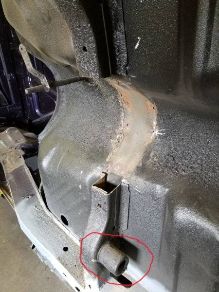

I just completed the USCartools subframe and front/rear torque box install after body work...required some convincing but they all eventually went in.
I also sectioned out the factory crossmember in preparation for the Tremec 6 speed on the way.
Question for the group: Since I am going with coil-over front end, is there any reason I cannot cut off the torsion bar 'perches' installed in the original crossmember? (the cylinders that run parallel to the driveline)
-Dave
I don’t see why you couldn’t cut them off... which front end are you using
