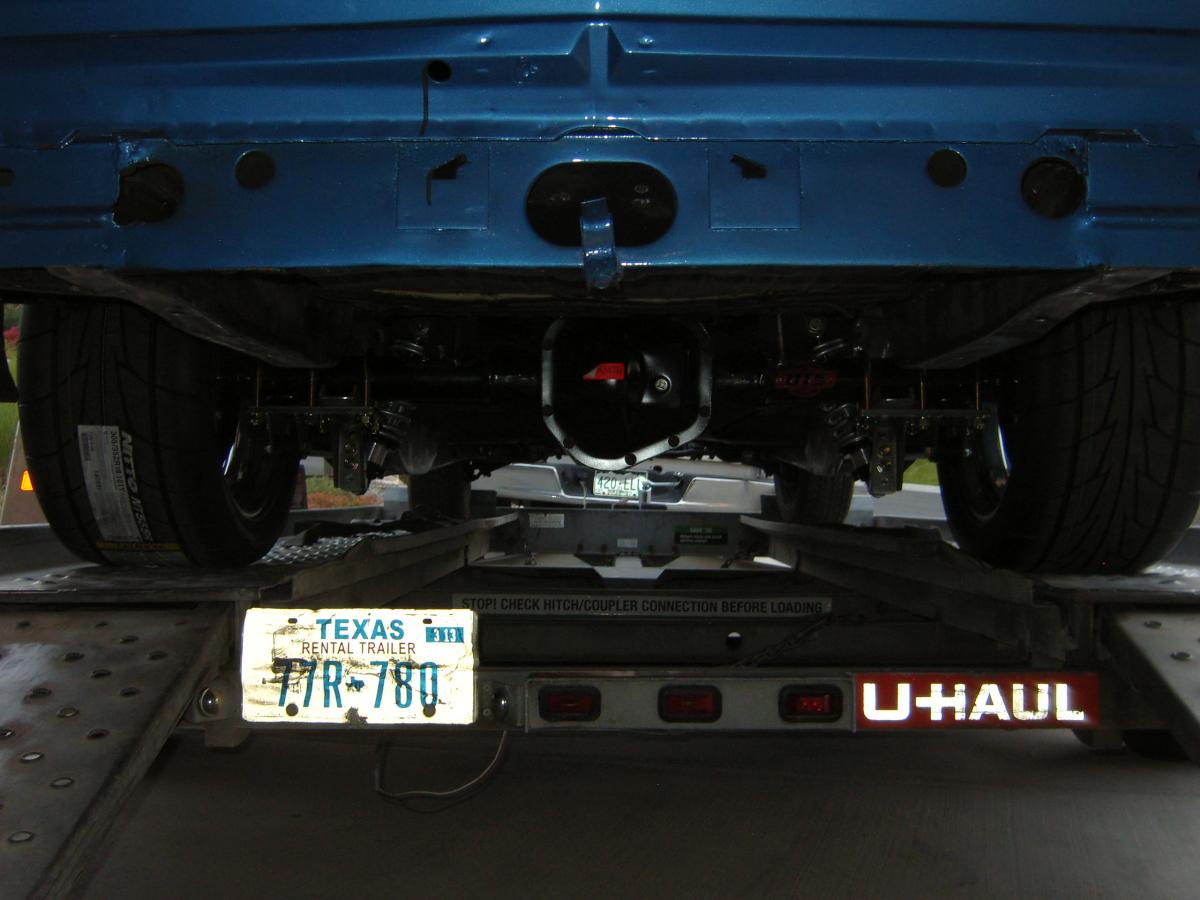

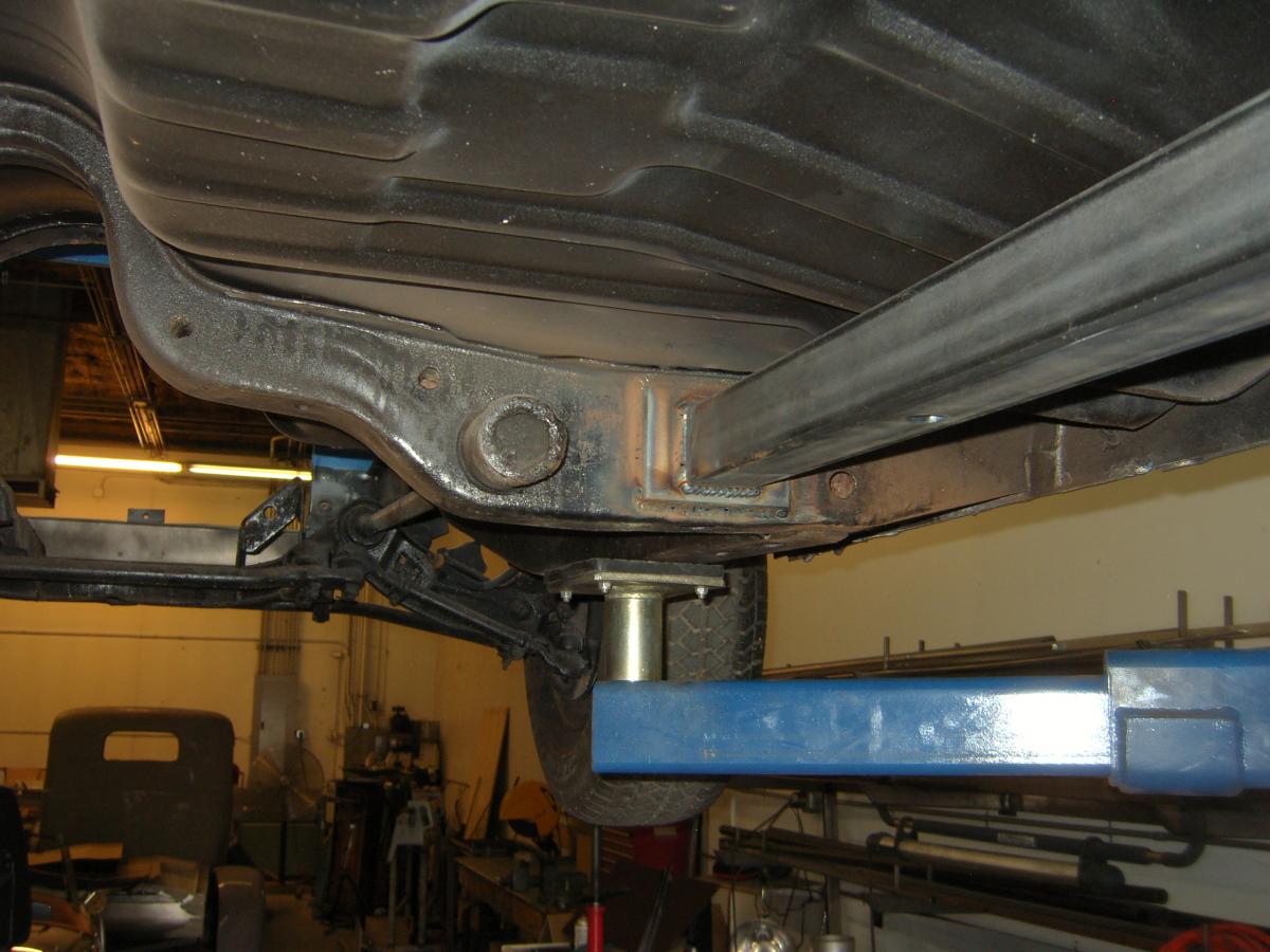

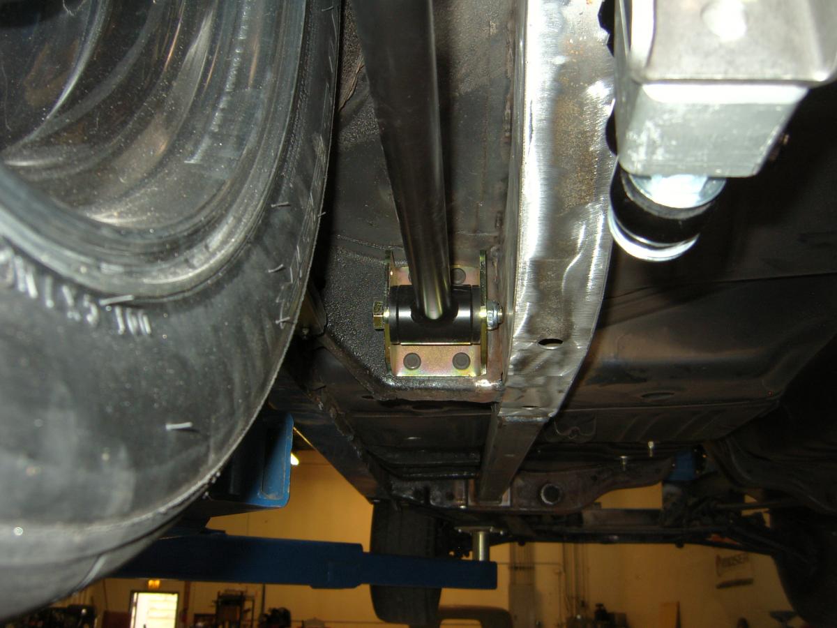

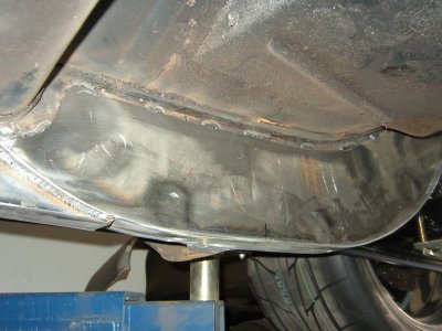

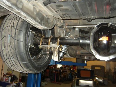

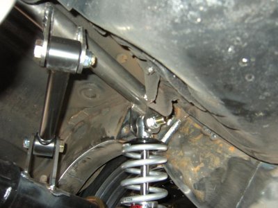

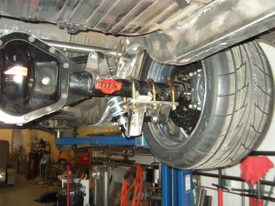

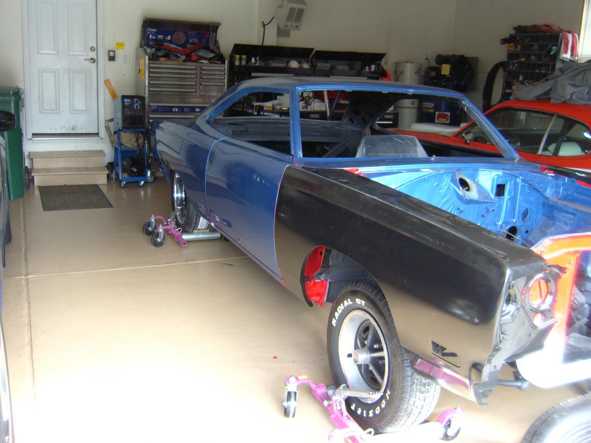

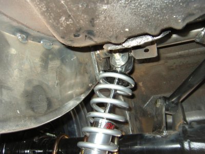

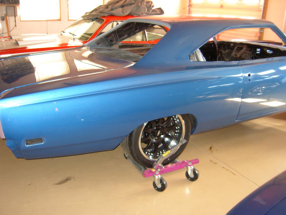

here is a few pictures

Very nice. And clean. I like the install, im assuming thats a kit. Im faund of the lower link/coilover mounts, where did you saource the setup from? Also. I am hoping to see some body color on that undercarrage in the future and not undercoating. Very cool. Two rhumbs
the suspension is Reilly motor-sports the frame rails auto rust technicians not a easy install do not recommend unless you have all tools did not fit very well a lot of cutting and fab work to make fit. i was thinking raptor bed liner as a under coat just for durability and to hide the poor job on the floor and trunk wields that was done (always look before you buy).
damn thats nice, makes me wanna go back to building street rods again and get out of the army. on thing i would have done diff is tig weld everything and spend a little more time on finish work but still looks freaking awsome!!
Very nice set-up! And BillMopar, trust me, hang in there, retire, and then go to work! I love it; endured 21 yrs, retired in 08, got my own shop (just need more room now) but I work on cars all the time, and or as much as I want to! Listen to Howard Stern all day long, take lunch when and how long I want, no time to get there, or leave, working for yourself is great if you can align it all to happen!
Without being there to look in person, it's hard to say it's a poor job but it looks pretty decent in the pics. I'm a firm believer in NOT using the bed liner to hide it. To me, it makes it look like someone was trying to hide something plus imo, the bed liner looks like crap and if you want sound deadening, use the dynamat or something similar on the inside.
good point on trying to hide thing maybe i will paint. on the welding it looks good to me tig welding would not turned out any better trying to weld to rusted metal is tough
Looks nice to me ...
Looks good now, get it painted up it will make it better yet. nice suspension set up..
Friggin' saweett!!! Looks good from my couch, lol!
