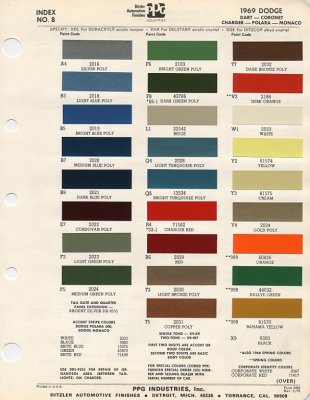

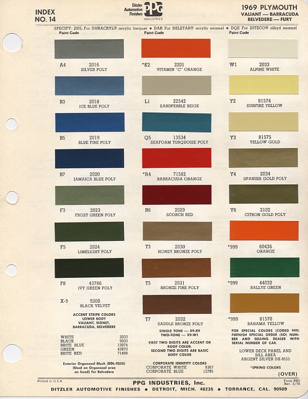

first one is 69 Plymouth, second is 69 Dodge...:tongue8:
As you can see, there are many shades of orange and red that unless side by side can be mistaken for one another. That along with lighting and what I will state below can make it all very confusing.
The 999 paint code shown is Omaha Orange (used by many utility companies back in the day) which IS DIFFERENT from Vitamin C or Go Man Go (same color) used in 1970 by Dodge.
As you can see from the paint chip comparisons above R4 is definately Red not orange.
Be very careful getting paint samples from the paint stores today even using the original paint codes. Paint ingredients and changes with the newer base coat/clear coat products often don't even closely match the original colors. The only way to match them is to match them to an original Dealer Color Book chip or and original PAINTED paint chips from the old PPG books from back in the day. You will find those in paint supply stores that have been around since back in the day that still have the originals. Have them color match it to THAT chip and not use the color formulas they have, as stated above they have changed.
How do I know? The guy that had my 78 Little Red Express Truck painted had the paint shop mix the new paint per the factory color numbers and the paint came out more like Hemi Orange than the correct Canyons Red.
