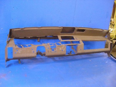

If you had your choice, having a non A/C dash in a car that is almost done and wanting to add A/C vents, etc., can the duct holes be cut with the harness out or would you just spend a few hundred on an original A/C dash and swap it out. My new windshield is already in...dang
I'd would think you could cut them out with the dash in. Just make sure the wires are out of the way (near the center dash area and sides) and use a dremel with a little cut off wheel. Looks like the lower dash pad would need to come out...pretty close for comfort. Here's a pic if it helps:
my lower dash pad is out as well as the harness. Just not excited about spending more money on another dash and then trying to get rid of the one I have.
I was thinking dremel too without removing the dash itself and then piecing together the other parts I need as I go.
