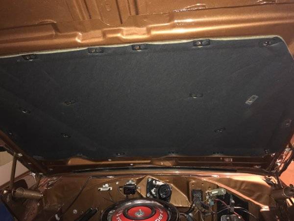

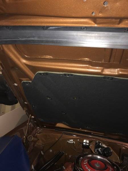

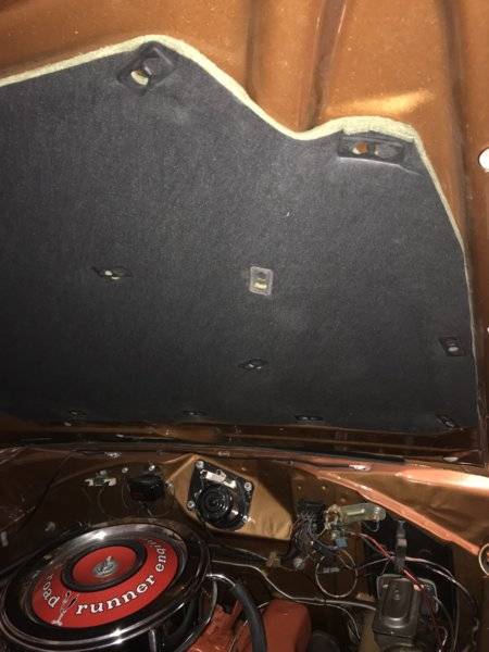

Just installed the molded one. The clips are very difficult to deal with and the corners of insulation are very delicate. I did it myself buy it's a little easier if you have a second person hold the insulation pad, just until you get all the corner clips in. I also put the new radiator hood molding on as well...that goes on very easy.
If you have the factory clips for the radiator seal clean and use them. The reproductions suck. I have to snap one or two back in evertime I open the hood after a freeway drive.
Car was missing the radiator seal when I got it....hope these clips stay in.
